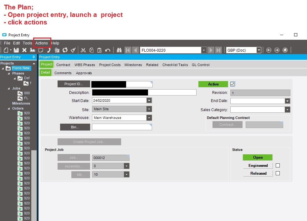

How To Apply Customisation on a Form only Accessed via Actions Menu?
In Project Entry (Service management > Project Management > General Operations) -
After loading an active project, click Actions > Revenue recognition
This pulls through form: App.ProjectEntry.RevenRecogForm
I have been able to customize this form, but I cannot apply the customization anywhereto make it stick?
What we want:
Am I missing something really simple?
I have created a customised version of the revenue reognition form, but can’t apply it.
The menu form is Project Entry, Erp.UI.ProjectEntry.dll
If I apply a customization here, it is applied to the Project Entry form, no the revenue recognition form which is pulled in via the actions menu once already in Project Entry.
This is the Project Entry form on the menu set up.
This is the customization in customization of the revenue recognition form in maintenance:
