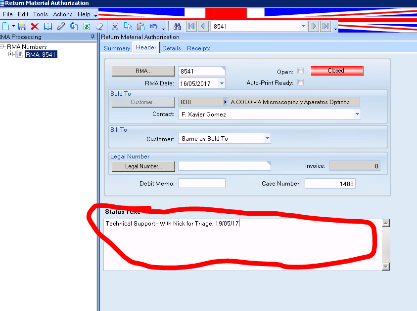

How to apply a user / date/time stamp ID to a text box
Epicor 9.05.701
The below field is RMAHead.Character01
How can i add a User, Date, and Time stamp to that field everytime somebody posts comments?

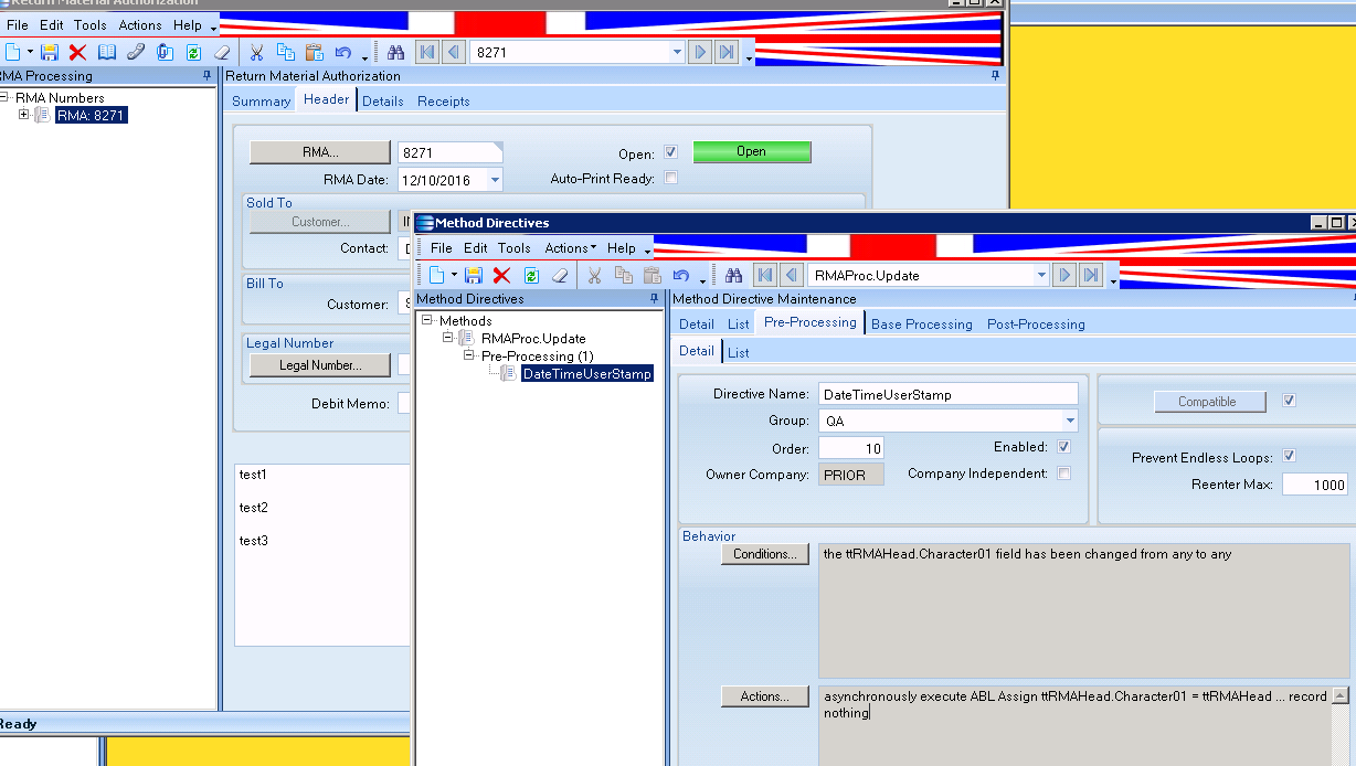

Pre-proessing BPM should take care of it, before Update
Set Character01 = Character01 + callContextClient.userID + NOW()
Looks like you are in 9 that’s not the exact syntax it would be in ABL, but that’s the gist of it. If you need the exact syntax let me know

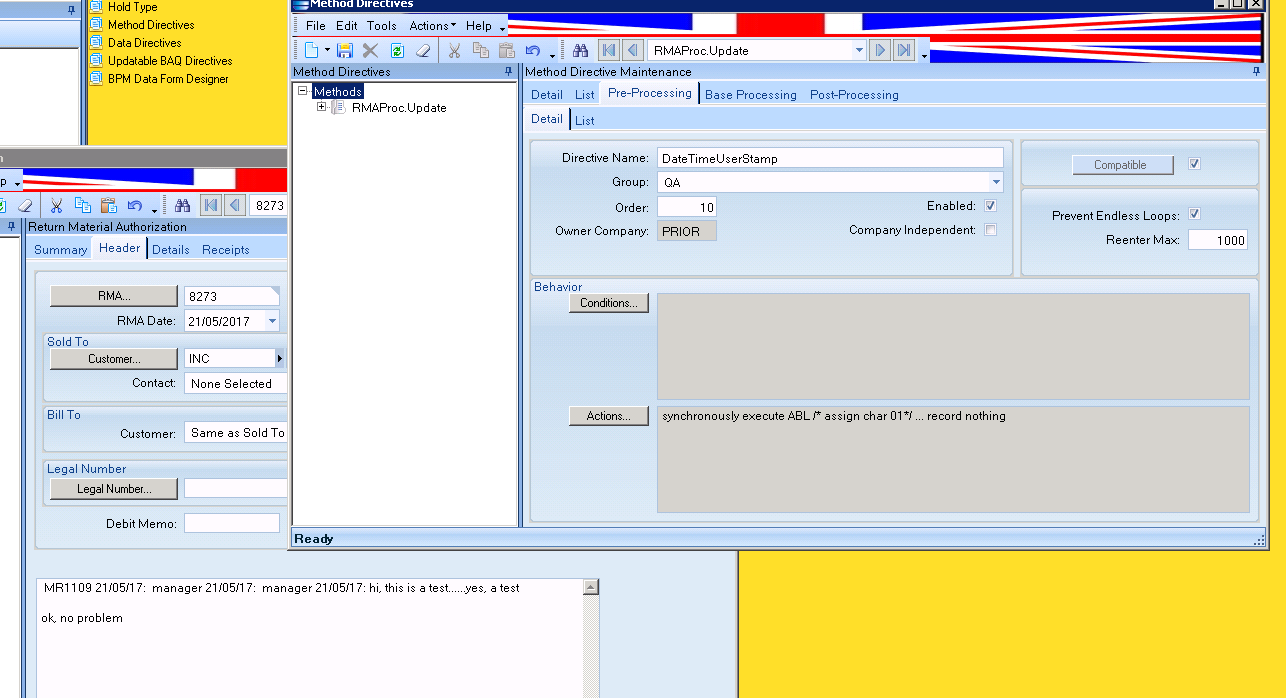

Hi Greg, - thanks for your help, its really close now…
Here is how i’d like it to work:
manager 21/05/2017 + time: hi, this is a test
manager 21/05/2017 + time: yes, a test
MR1109 21/05/2017 + time: ok, no problem
Here is the code i’ve used:

Here is how it is looking:
String (time,“HH:MM:SS”) will get you the time.
What I would probably do to make the prefixing of the entry work is to use another character field for them to enter the comment and then build character01 into the log and clear the entry field.Then users can’t mess up the entries. You could even make the field read only with a customization.
I would also build this in reverse order, so latest comments are on top. Put the ~n at the end of each new entry before ttRMAHead.Character01 and the comments will all start on a new line.

The only small problem i have now with the current setup is that every time i click save (even if i’m not working on that field) it returns the User/Date/Time…i only really need to see that when a comment is added
/* assign char 01*/
For each ttRMAHead.
Assign ttRMAHead.Character01 = “~n” + ttCallContextClient.CurrentUserId + ", " + string(Day(Today),“99” )
  • “/” + String( Month(Today),“99”) + “/” + substring(String(Year(Today),“9999”),3,2) + ", " + String (time,“HH:MM:SS”)
  • ": " + ttRMAHead.Character01 .
    End.
Thanks.
Mark
Set your condition to ttRMAHead.Character01 is changed from any to any.
Set the condition on the input field has been changed from any to any.
IE
the ttRMAHead.Character02 has been changed from any to any
Then use Character02 in the assignment and clear it.
