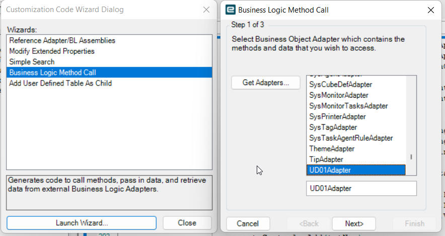

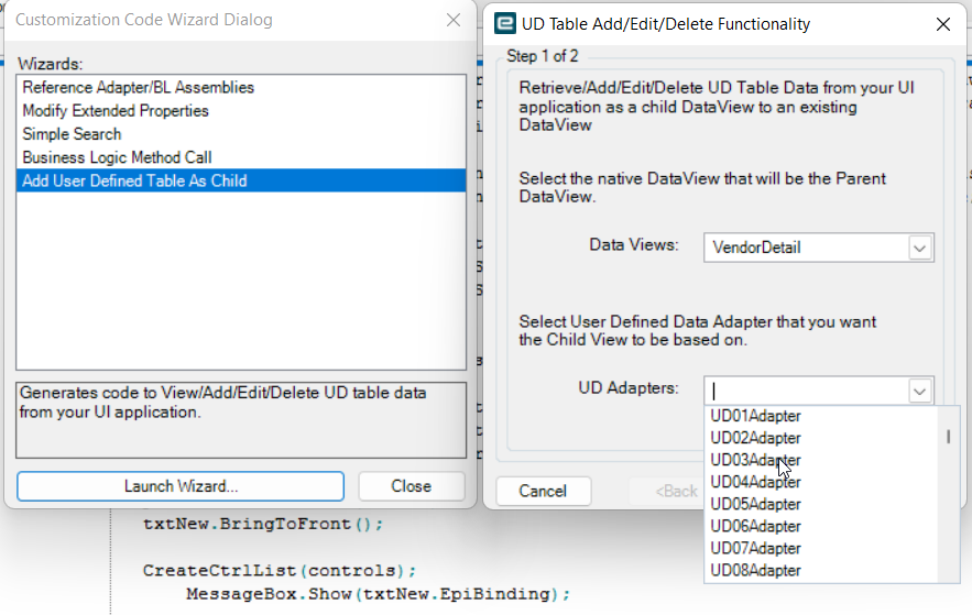

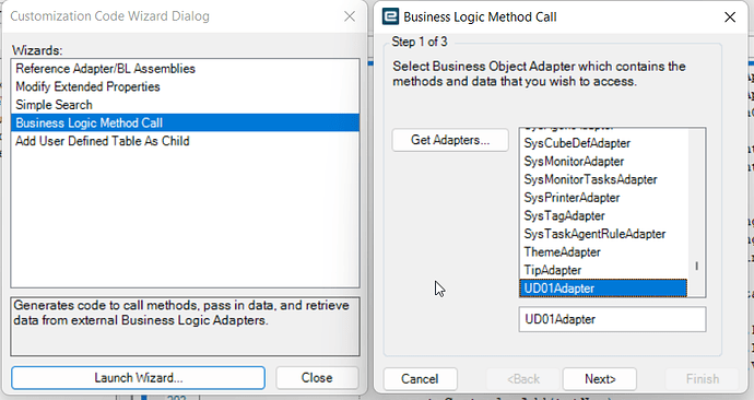

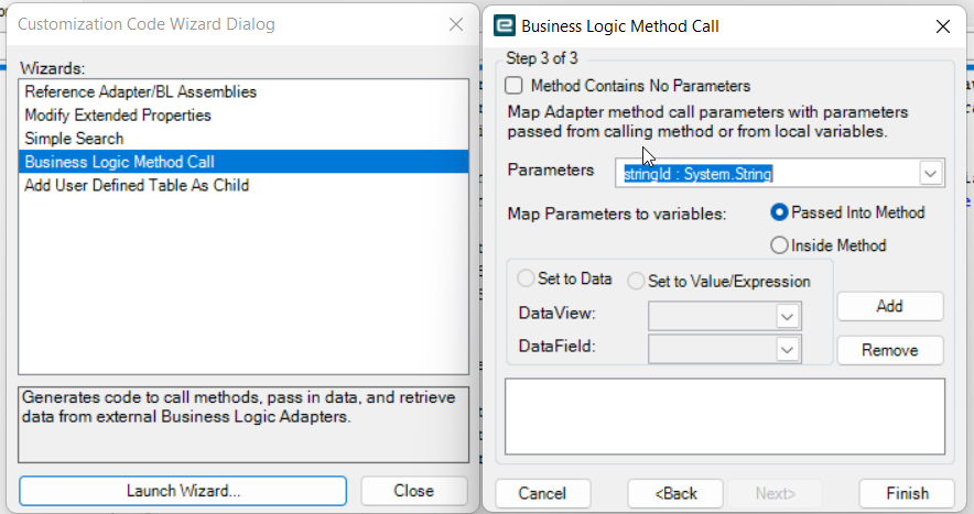

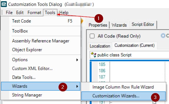

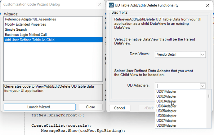

My guess
you are trying display data in UD table in a control in customization.
Without going into much details, Epicor is able to create a template for you, which you can amend to suite your needs; take note of EpiDataViews connected to oTrans where updated data from you chosen table will be available to Read/Update (be sure you are using a backup copy of your customization as Saving Code with Errors and reopening the form will lead to you loosing the customization).
