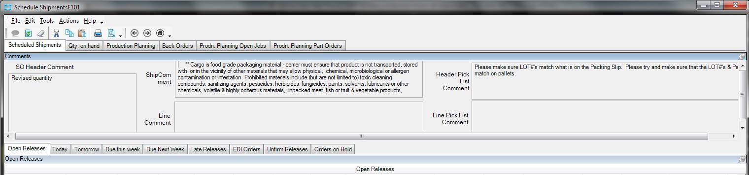

WE also have a dashboard which is used by production planning and Shipping. We started with the BAQ used for the Sales Order Status Dashboard that comes with system and made changes to suit our needs. Over the years we made many changes, including summarizing by parts etc.
It looks like this now.

there is a standard Dashboard you can use, to see all open orders releases (demand), due dates, etc and if there is any links to possible supply (Jobs, Stock, PO, etc)
Thanks! I used this BAQ as a starting point to build up what I needed.
