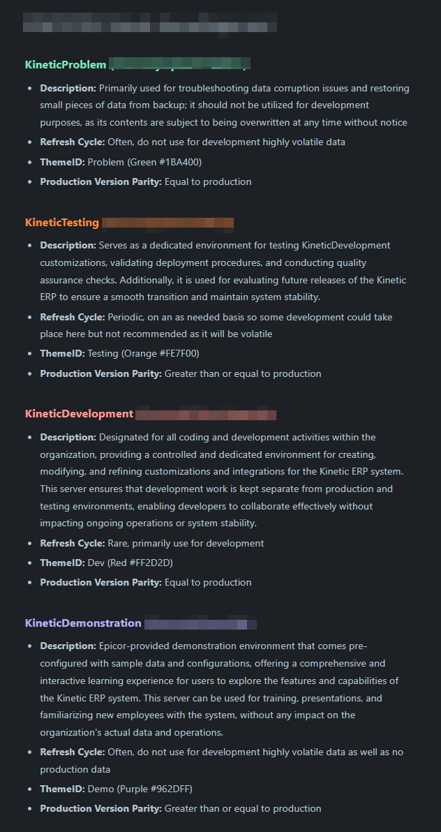

Didn’t even consider those for this question. I have SSRS installed on all instances (and keep it up to date even with my custom reports). I also have a Dev ECM instance, and my ‘script’ takes care of ECM, QuickShip, Avalara, and Collaborate connections to the associated “dev” instances (or whatever needs to change). All of my non-Prod instances point to the Dev instance of those products.
My internal doc. Colors are reflected in themes and top bar of Kinetic menu

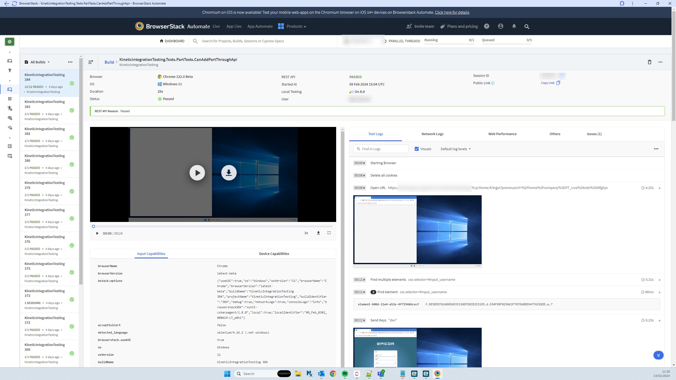

We are currently doing automated testing (POC) using browser stack + selenium for both ui & endpoints.
My colleague designed our unit tests and has written up some awesome documentation. (Reserved for Ry)
