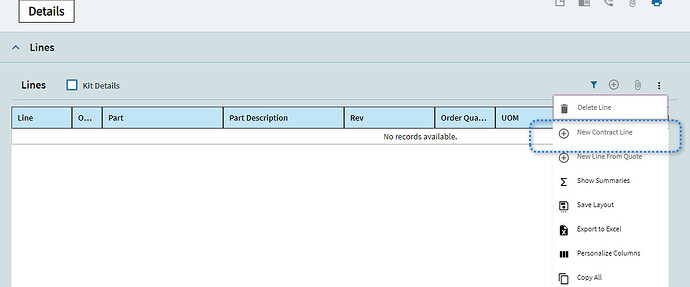

The service contract offering is notoriously weak in Epicor, which is why we are writing our own. In classic Epicor, there was a ‘New Contract Line’ option is Order Entry. is that not available in Kinetic ?

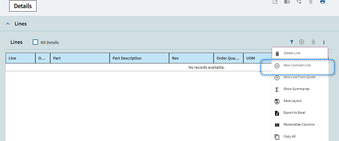

I just found it in Kinetic

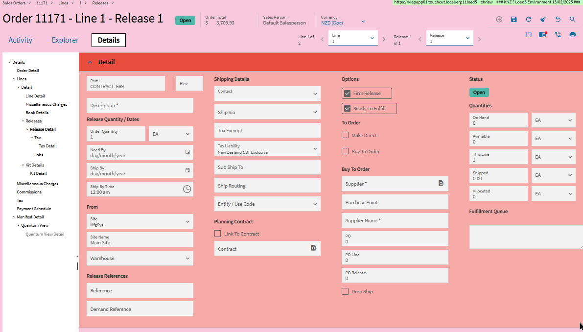

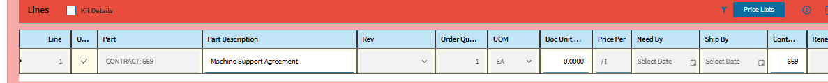

@AndyGHA I also found the New Contract Line menu option but not having much luck with it; I enter the contract number, (pink as its a test environment :blush: )
…Brings across the price and details… all good.

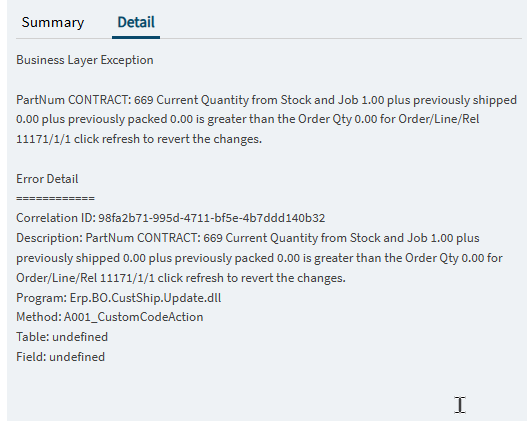

But I need to ship the sales order to invoice it, and I then get stuck:
I don’t understand what its on about, line and release both have order qty 1: ** UPDATE this error message is coming from one of our own BPMs, will look at with our BPM developer :slight_smile: **
looks like that’s coming from an exception in the catch part of the code widget in that bpm on CustShip.Update
Indeed it is, have sent it off for review by those who know their C# from their D flat.
Maybe its an E minor. LOL :rofl:
SUCCESS UPDATE
We were able to successfully put the contract on a sales order, which allowed us to add our loyalty discount part, and invoice it successfully.
