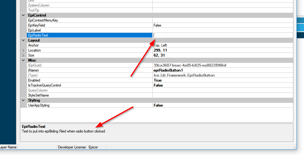

I do have another question, how do you get the below to show?
I don’t know, it’s just there… Not all of the fields have stuff in it. This one happens to.

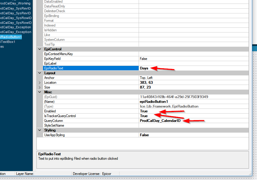

Ok, For a dashboard tracker you don’t use the epibinding. You use the Query column. Make sure enabled and IsTrackerQueryControl are set to true, and then you can pick a column. Give that shot and let me know if it works.

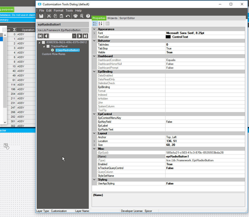

Didn’t work for me. Here is a screen shot of the set-up.
So you have all 3 set up, and you refresh after you change the radio button? I’ll go farther through the testing and see if it works for me.

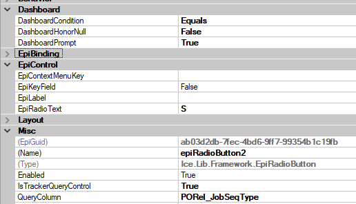

I threw a trace on. Look what is being passed, it’s weird.
 <parameter name="executionParams" type="QueryExecutionDataSet">
      <QueryExecutionDataSet xmlns="http://www.epicor.com/Ice/300/BO/DynamicQuery/QueryExecution">
        <ExecutionSetting>
          <Name>Where</Name>
          <Value>(PORel_JobSeqType = N'epiRadioButton2') AND (PORel_JobSeqType = N'epiRadioButton1')</Value>
          <SysRowID>00000000-0000-0000-0000-000000000000</SysRowID>
        </ExecutionSetting>
      </QueryExecutionDataSet>

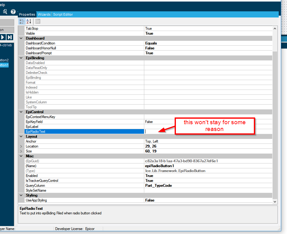

yeah, for me, after I save the dashboard and re-open it, the text value won’t stay. It clears it out for some reason.
I think I’m about stuck. I don’t know if it’s going to work for a dashboard tracker value. Maybe that’s why people don’t use them much…

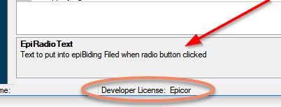

Would I hazard to guess that the reason is that this is shown because you have the SDK?
I’ve never seen it
This is what I get when I am in developer mode
We do not have an SDK license. If we did, I wouldn’t even know how to use it!
Maybe it’s a 10.2.200 thing? We are on 10.1.600, and a demo 10.2.100 environment I get the same thing.
