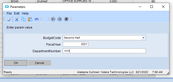

What I want to do is pass a few parameters into the report/BAQ, as the report is Budget v Actual for different departments.

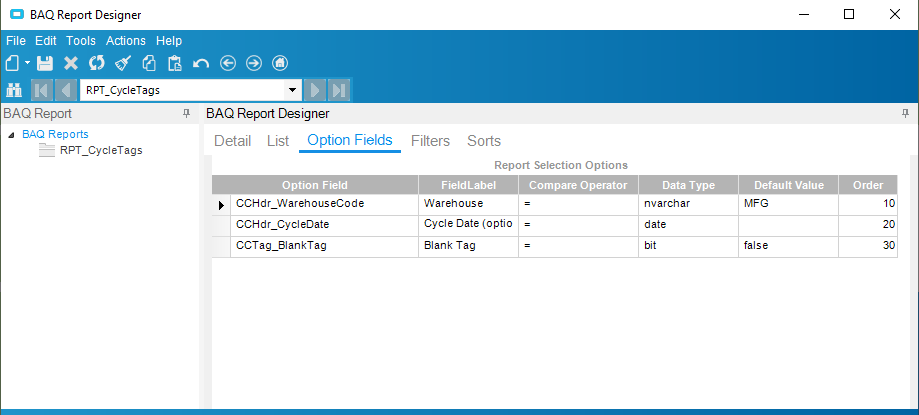

Have you looked into the BAQ Designer’s Option Fields when running the report?
I’m looking at that now, is it possible in the options field to allow a drop down?
Or would that require the filter / sort?
Edit: I want to filter based on BudgetCodeID, but I’m only showing FiscalPeriod/Year

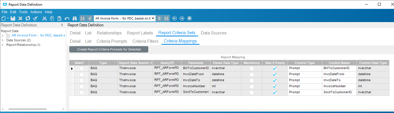

But if you create a Report Data Definition, you can base it on a BAQ, and it finds the parameters automatically, and there’s even a button to create the prompts for you. This is much easier than I thought it would be. The implementation guide explains it well.

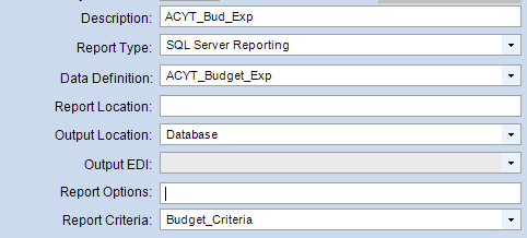

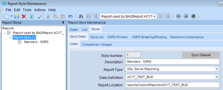

I created a report and report style:

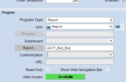

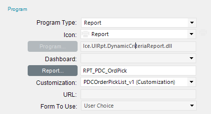

In menu maintenance, it seems to be changing my URL
What setup do I need to do so that I can test the report and passing in parameters?
I don’t really understand the URL bit. For a different report, mine looks like this:
You don’t need a customization, but the title bar sure is ugly if you don’t. Unless there is an easy step I am missing.

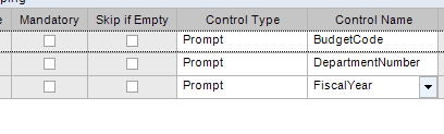

Report Data Definition Criteria Set/Prompts created
Report style created:
Menu maintenance setup:

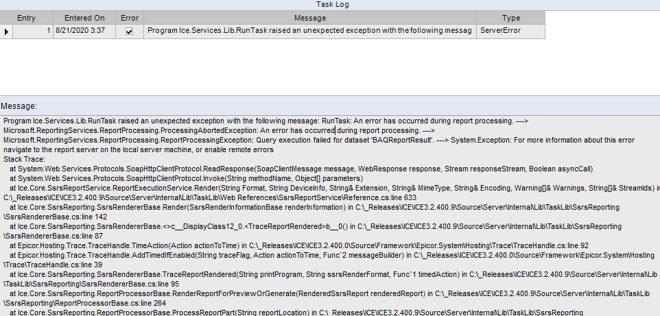

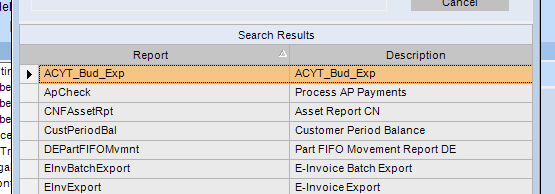

I’m able to navigate to the menu and attempt to run the report; but receiving an error in the system monitor.
I think you picked the wrong “Report…” in menu maintenance. I think you referenced the BAQ Report and not the RDD version.
That’s all I’m seeing, maybe I missed something in the setup?
Right, your screenshots make sense, but the error references the BAQ report. I don’t know; you might just need to start from scratch and use a different name for everything.

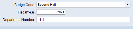

So I’m working on recreating that from scratch now, I’ll see how it goes. Assuming I’m able to get that up and running, is it possible that instead of a text box input, I can use a Combo box and pre selected values?
Or something along those lines?
