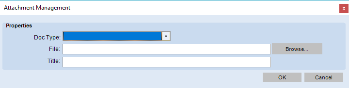

I’m trying to filter out the Doc Type field in the Attachment Management form (I’m off of Case Entry), but I can’t seem to customize the form. I want to do a similar filter here to not display any doc types where the description begins with an asterisk, but I am unable to customize anything on this dialog box.
Windows without a toolbar can be customized by right clicking in the form (assuming you’re in developer mode). On the pop-up menu will be how you enter customization mode.
