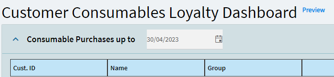

Scenario:
A dashboard driven by a user entered date.
When the dashboard is launched in Kinetic, the slider pops out, user enters the date. I would like to show on the dashboard the date they selected/entered.

I guess my underlying parameterized BAQ could return a column that is the value of the parameter, and I could just hide this column from my dash, and link a text box to it? Bit ugly… Will let y’all know if it worked.

passing the parameter back through the dashboard as an invisible column worked ok:
I’ve done it this way. I agree, it’s not the tidiest but it works.
