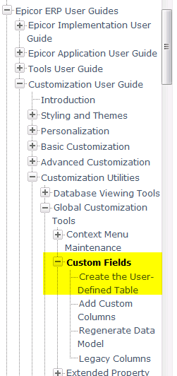

Search the E10 help for “Create User-Defined Fields”
or go to the following in the online help:
That will walk you through adding the column and regenerating the data model
