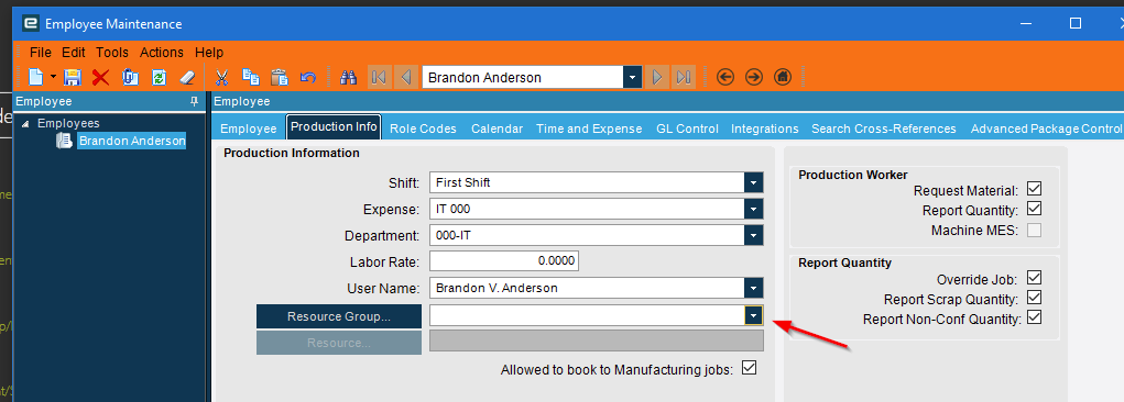

I’m pretty sure that setting this will do it.
More than likely through Employee Maintenance. Look under the Production Info. If someone assigns an employee a Resource Group, it automatically adds them as a resource.
Do you know if this is automatically done by any task? I bet someone just starting doing it for no reason.
Make a simple bpm that clears the resource group on save. It will save you in the long run.
I was just thinking is there a way I can prevent this from happening in the future? I will put a warning up or something.
Or just make the field Read Only.
