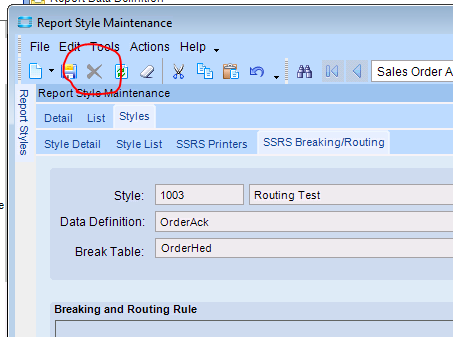

One last thing: Deleting a Break/Routing isn’t straight forward. There’s no “delete” button on the Break/Routing tab, and no “row” to select on the form. And the Delete icon in the toolbar is diabled.
Just click the Style Number on the Break/Routing tab - yes it’s Read Only, but the cursor will make that field in focus - enabling the delete button on the toolbar.
