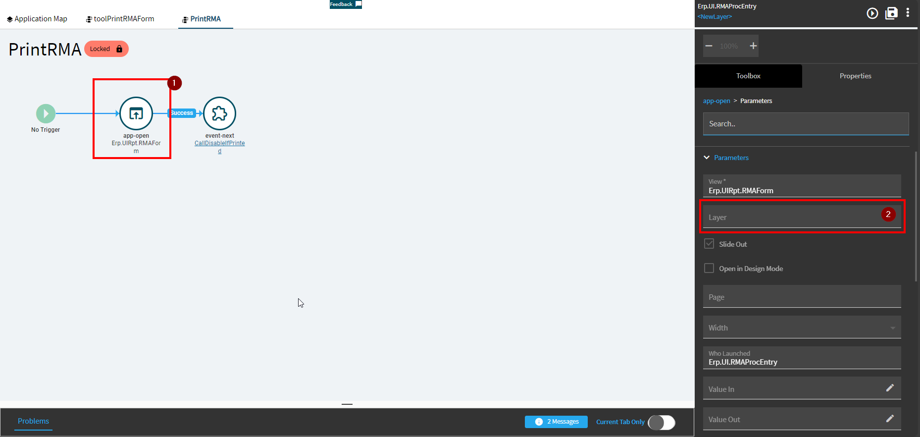

Yes, but I am trying to calling the layer as a slide out from within Erp.UI.OrderAllocEntry. Is there a way to call a layer in a slide out as a tracker?
James, if you have not figured this out, you can pass application studio layers in slide out panels, it’s in the event that opens the slide out
You can pass multiple layers there, I think you separate with commas, maybe tildes or semicolon? I can’t remember which one is correct. I did it once before.
