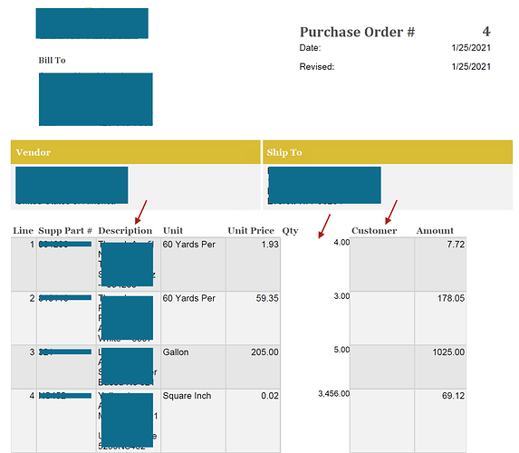

  1. Quantity - I need the value from the POForm_PORelQty (subreport, I guess it is) to show in the table. It does. But I can’t format it to style it like the other fields. I have no options to change the background properties. Can I pass the values to that field instead somehow? Or am I missing how to style it?
  2. Customer - we need to be able to see the customer associated with each line item. As far as I can tell, that information is in the CalcMangCustID field in the PODetail dataset. And I don’t see the PODetail dataset listed in the report. I sort of understand how I can add a field to an already connected dataset by editing the query code, but I’m not sure how to add the PODetail dataset to the report. Or is there a better way?

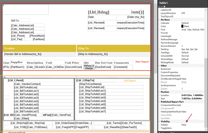

  3. Description - for some reason that I really can’t understand, whenever I try to widen the description column in my table it throws off Tablix1 below and I get an error that says “The Hidden expression for the tablix ‘Tablix1’ contains an error: The expression references the field ‘RptLiteralsLVend’, which does not exist in the Fields collection.” As soon as I undo changing that particular column width, it runs just fine. I can widen any other column in that table and it’s fine. What in the world?
In case a visual helps, here’s what I get when I run the report:

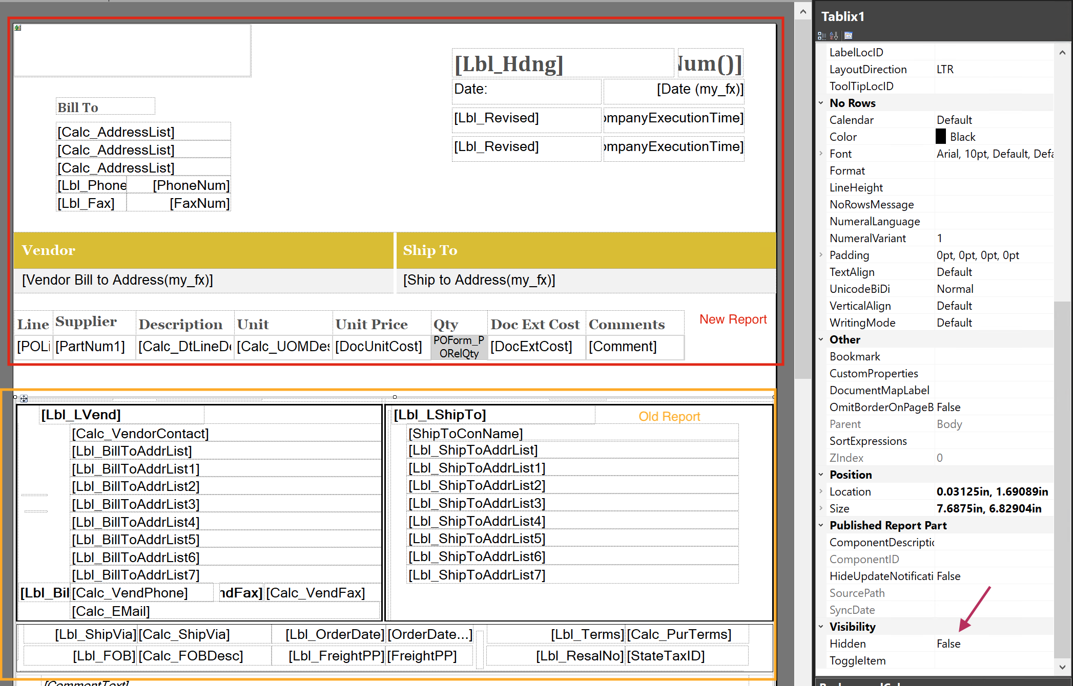

That’s what mine shows as well. Here’s how it looks in Report Builder:
Yes, what I was showing was the printed version of the report I’m building - inside the red box in my screenshot above. The portion in the orange box is the original report, including Tablix1.
That’s what’s so odd. When I just widen the one column in the new portion I’m building and save it without changing anything else, I try to preview it and I get the error about a hidden expression in the original part of the report. If I undo the change and save it, I can preview it just fine.
I can try digging for that field in the Tablix1 and see if there’s anything odd. I’m so new I’m not sure I would see it.
Theoretically if I’m just going to delete the old portion eventually it may not matter. But I’d like to keep it until I know I have everything I need from it. In the meantime I can’t widen the description column to make the preview easier to work with. Anytime I do it breaks :confused:
OK. I won’t assume anything and just ask to make sure your objects are in the Body, not the Page Header. Not sure why you would get such a strange error, but looking at where the Tablix1 is selected, this is probably worth double checking. Report Builder lets you place objects up there, but you won’t be able to reference a field directly, only in aggregate function or in code reference to a set variable let’s say.
I don’t know, Previews fine, interesting error.
Yes, thank you for checking. The yellow and grey rectangles containing the vendor address and ship to information are in the header. Everything below that is in the body. Sorry, it is kinda hard to tell from my screenshot.
So, I don’t think that would do it… Especially since, as you say, it previews fine until I change the width of just the one column in that top table, which is the first one in the body.

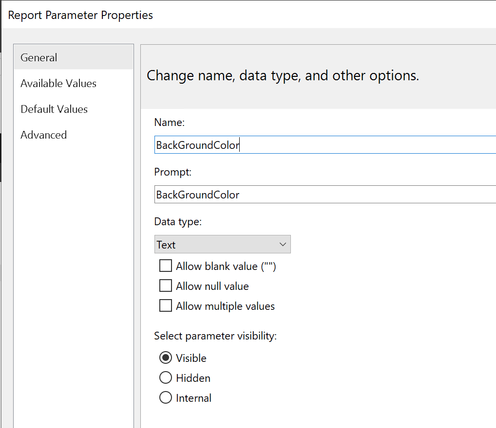

  1. In the subreport (in this case POForm_PORelQty) add a parameter. I called mine BackGroundColor.

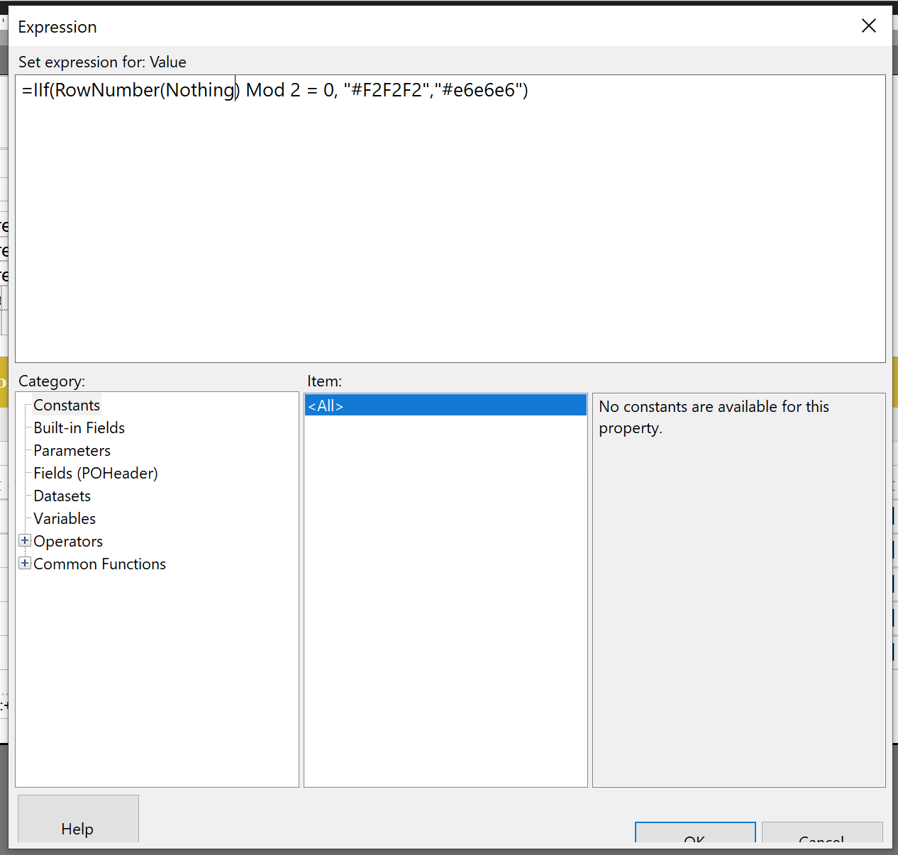

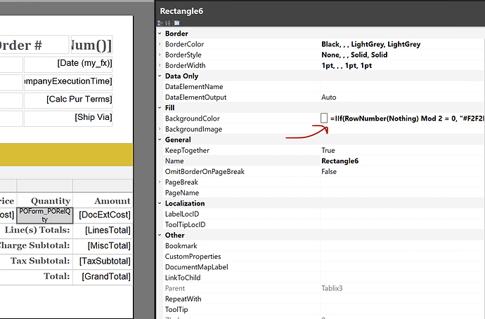

    4. In the main report - in the cell where the subreport should go, add a rectangle and set it’s background color with the same expression used to alternate the colors in the rest of the row - I used =IIf(RowNumber(Nothing) Mod 2 = 0, “#F2F2F2”,“#e6e6e6”)
    5. Add the subreport to the rectangle.

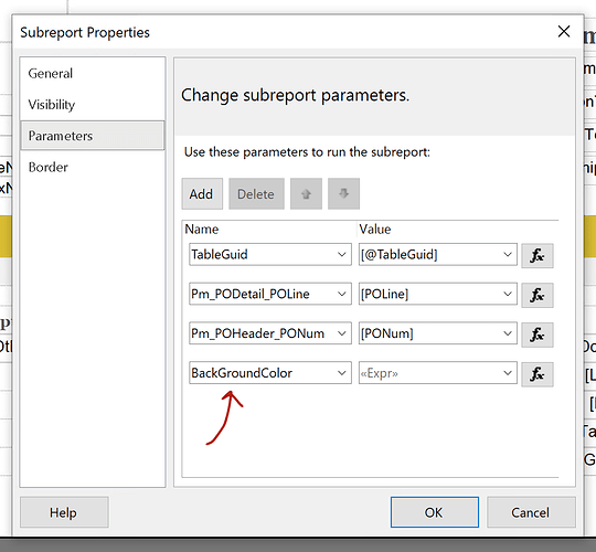

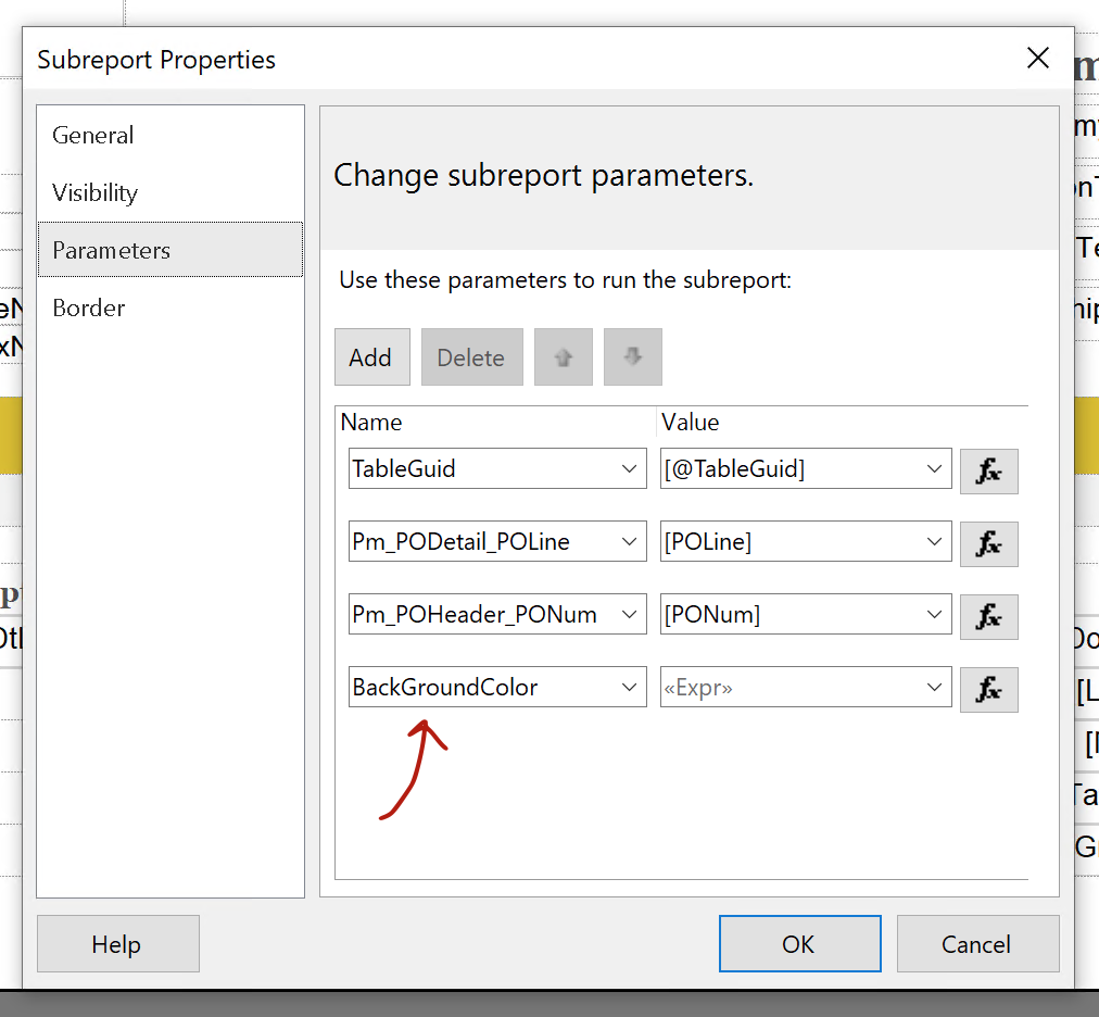

    6. Right-click and go to subreport properties, then parameters. Add a new parameter called BackGroundColor.
    7. For the parameter value add the green bar expression again - =IIf(RowNumber(Nothing) Mod 2 = 0, “#F2F2F2”,“#e6e6e6”)
