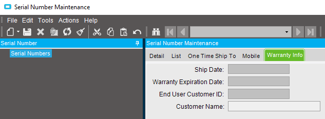

I have been tasked with creating a new tab in the Serial Number Maintenance screen for Warranty Info.
I added a textbox for them to add a new Customer ID.
They want it to show the customer name next to it.
I am unsure on how to do this in the screen customization.
I created a textbox to hold the customer name (txtCustName).
Any ideas on how to reference the customer table to find the appropriate customer ID and return the Customer Name?
Any help is truly appreciated!

I am doing what they asked.
If it’s not possible, I will have to backtrack and see what they think on that.
But mainly, I am asking how to pull data from a table that is not directly referenced by the screen customization, if that makes sense.
What code will grab the customer name from the customer table based on the CustID supplied in the ‘txtEndUserCustID’ textbox?
I feel like it shouldn’t be that hard but I am not that good with this. I just don’t get to do it often enough to be proficient.
