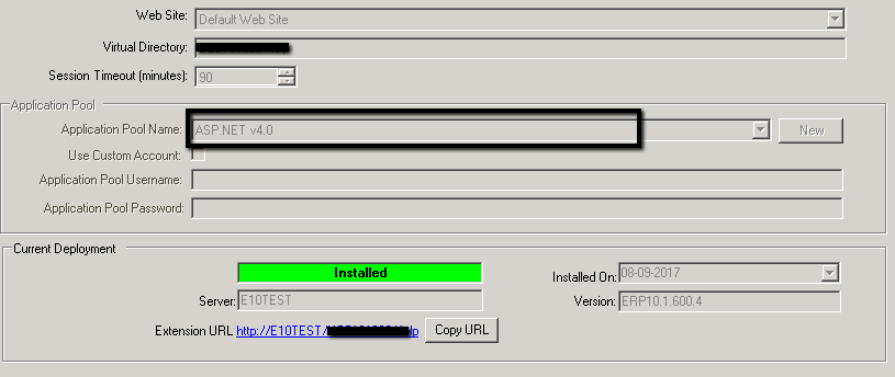

Which application pool you have used in your installed Help Extension ?
see the reference …

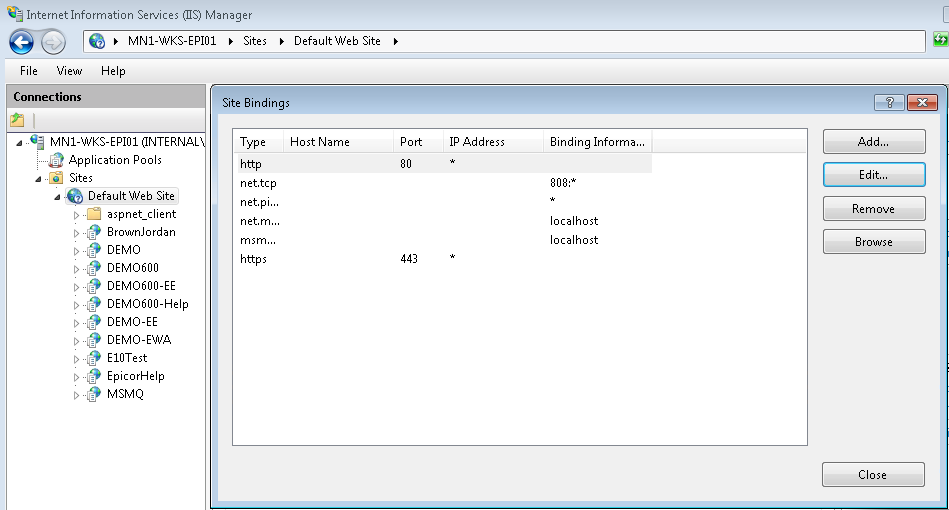

It sounds like help is installed correctly and you have some potential host name or binding issues that are causing some problems. The fact you can access using localhost typically means the install is ok. Take a look at your IIS bindings (may not be the same as the screenshot but should be similar). Also, on the server that hosts the help, from a command line, run the command ping -a 127.0.0.1 and see if it responds with a server name
