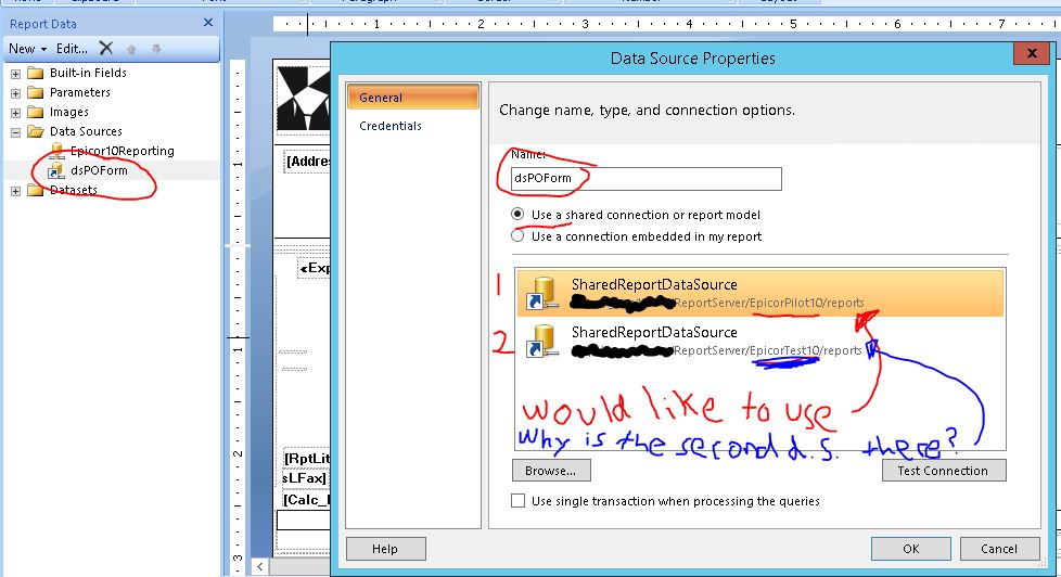

Do I need to do anything with the native shared data source in the .rdl’s? I have a picture of the ssrs report data source after uploading it to our Pilot environment from our Test environment and I see two (2) shared data sources. Please see the picture. Did I do something wrong or is that an expected result. Is there any way to delete one of those?

@danbedwards Thanks for your solution. Regarding the two data sources in the picture, is there any way to get rid of one of those? What is it that tells the report to always use the Pilot data source and not the Test data source?

Just to rule out one thing before going much further. Open the report in report builder. Click the Report Builder symbol in the upper-left corner and select Options. Change the highlighted option to a value of zero. Now see if you see multiple data source connection.
@greg.bakker and @danbedwards Both of you gave me solutions to the issue, I particularly like the download and upload of the reports either in SSRS report server or from within Epicor itself. @danbedwards , thanks for the additonal bit about showing x amount of shared data source connections.
