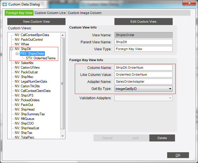

Naah, just use the Data Tools, from the Tools drop down, and create a Foreign Key View.
Could you be more specific. Not been doing this for very long and still learning terms, locations, etc…
Holy Crap!
I skimmed the manual I have for Foreign Keys and poked through it.
Linked my textbox to it and tested, worked great!
I really need to learn when foreign key will do!
Thanks a million @Jonathan_Lang!!
I appreciate the point in the right direction!
I’m having issues uploading some pics for you. You’re going to create a Foreign Key View (FKV) and a Sub Key View (SKV). I just slapped this together for you. You may want to connect ShipHead to OrderHed. You’ll have to do the testing to make sure your columns work.
But in the mean time open your Data Tools from the Customization Tools Dialog box --> Tools --> Data Tools
Hope that gets you started.
