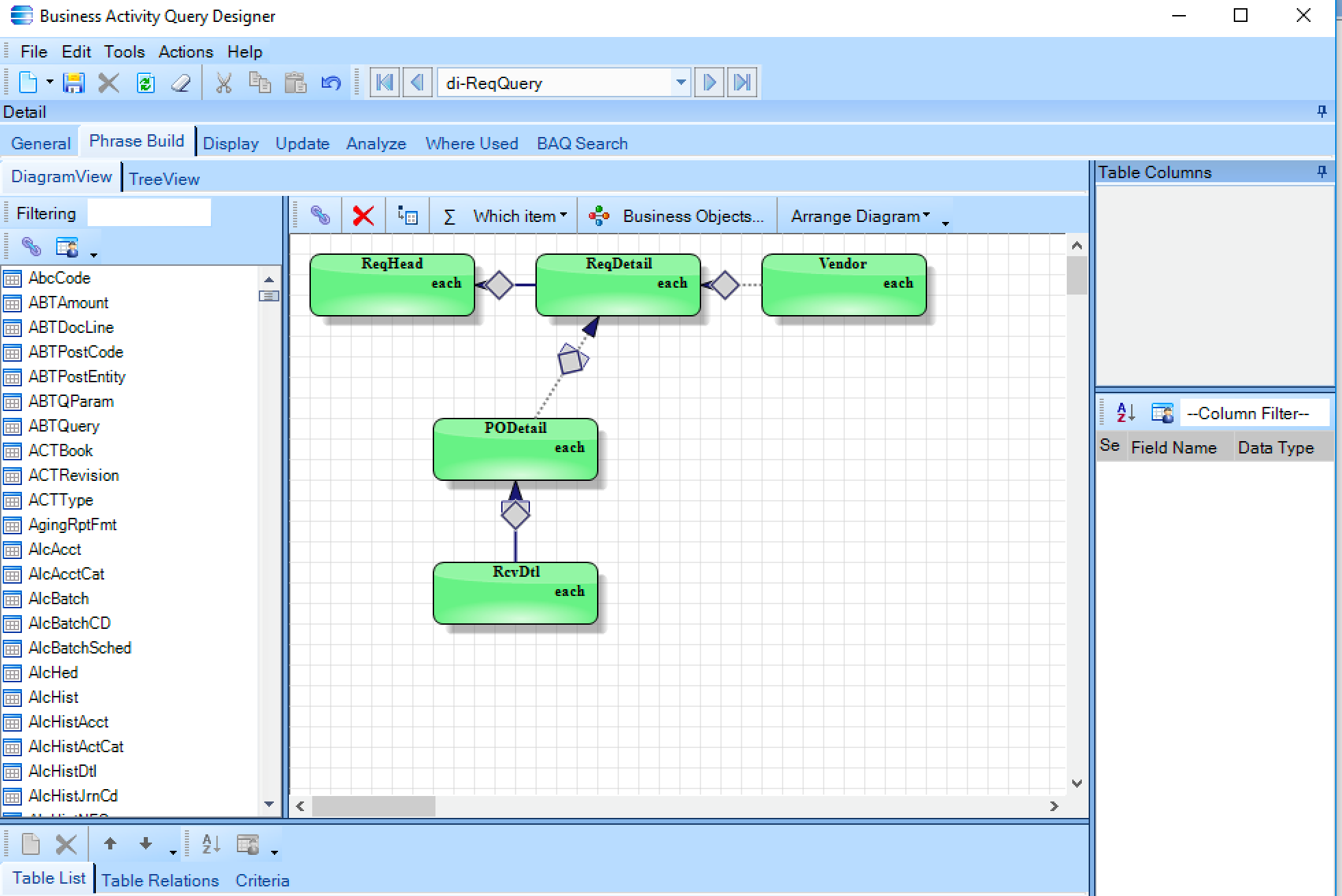

And finally, From E9 to E10, where has RevDtl gone from the BAQ table list? its in the bottom of his build but not on my E10 system.

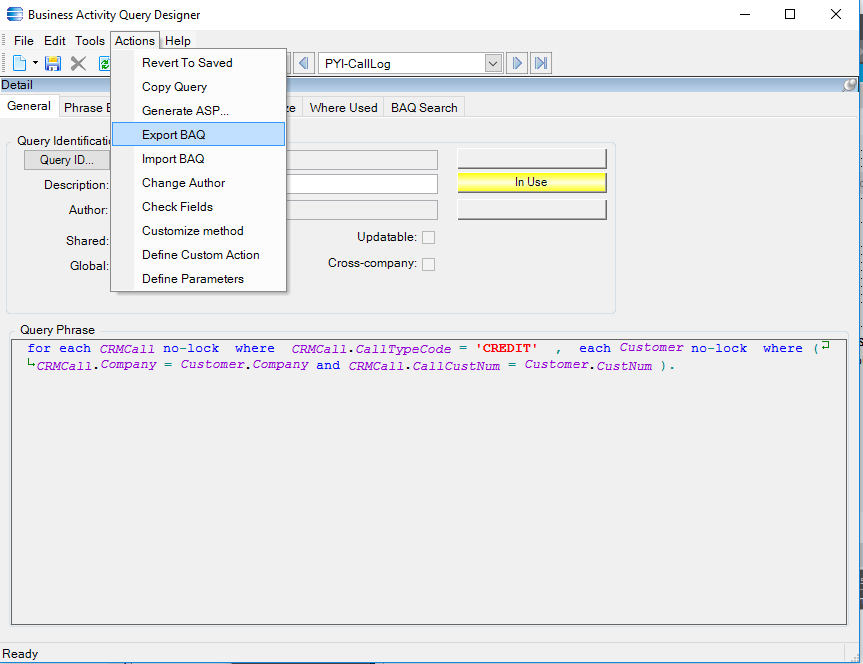

To Export A BAQ in E9. Open the BAQ and from the Action Menu select Export BAQ
You are prompted to Export to File. Enter file path
Then click Export
right that’s what i instructed him to do but when he clicks export baq in the actions dropdown hes presented with nothing. hes tried on the system account as well as his own.
Is that C: drive in the “Export to File” location with respect to the client machine or the app server?
The Client. The file showed up on my desktop.
Just an FYI. I don’t find the RevDtl in E9.05.607b either. Not sure what table that is.
That’s the RcvDtl
Receiving Detail. Contains the detail line items of a vendor’s packing slip.
DELETE: Not allowed if Invoiced = Yes.
Oops, I was going off @Joe_Tahan description ‘RevDtl’ . RcvDtl is available in both E9 and E10.
yeah … I should have replied to @Joe_Tahan
Appreciate the update! ill add that into the baq. was a little hard to read that screenshot text!
Any idea as to what conditions or relations need to be met from the text attached to the original post?
You mean the table relationships?
Looks fairly straightforward
for each ReqHead no-lock ,
each ReqDetail no-lock
where
  (ReqHead.Company = ReqDetail.Company
   and ReqHead.ReqNum = ReqDetail.ReqNum ) ,
each Vendor no-lock where
(ReqDetail.Company = Vendor.Company
 and ReqDetail.VendorNum = Vendor.VendorNum ) ,
each PODetail no-lock,
each RcvDtl no-lock
outer-join where
  (PODetail.Company = RcvDtl.Company
 and PODetail.PONUM = RcvDtl.PONum
 and PODetail.POLine = RcvDtl.POLine )
outer-join where
 (ReqDetail.Company = PODetail.Company
 and ReqDetail.PONUM = PODetail.PONUM
 and ReqDetail.POLine = PODetail.POLine ).
