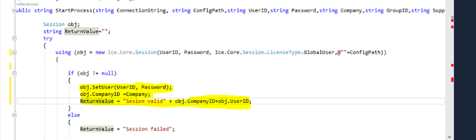

Try the below one.
Thank you I will try specify CompanyID
I noticed Licensetype you use GlobalUser I use Default.
What are the differences between the two? OK to leave as default?

The whole issue was that the username and password used in the .Net to establish the session was the same user in use when the new company was added. Then the user closed the Epicor. Well it saved the last company this user was in at the last use, which was the new one…, which did not contain the sites the .Net app was trying to use. Thus the site connection error.
We solved this by fluke (and later understood why… :wink: ) whe we went into Epicor under our current company and closed Epicor. (I did not test yet specifying the company in the connection, but I am sure it will avoid such issue)

Correct this will always be an issue in multi company environment
Your safest bet is to code in a session company switch in your app to ensure this ever happens again
Or make sure the account you are using doesn’t have access to the secondary company
What we will end up do is the create a user just for the applications…instead of the master account…
Thanks Jose!
