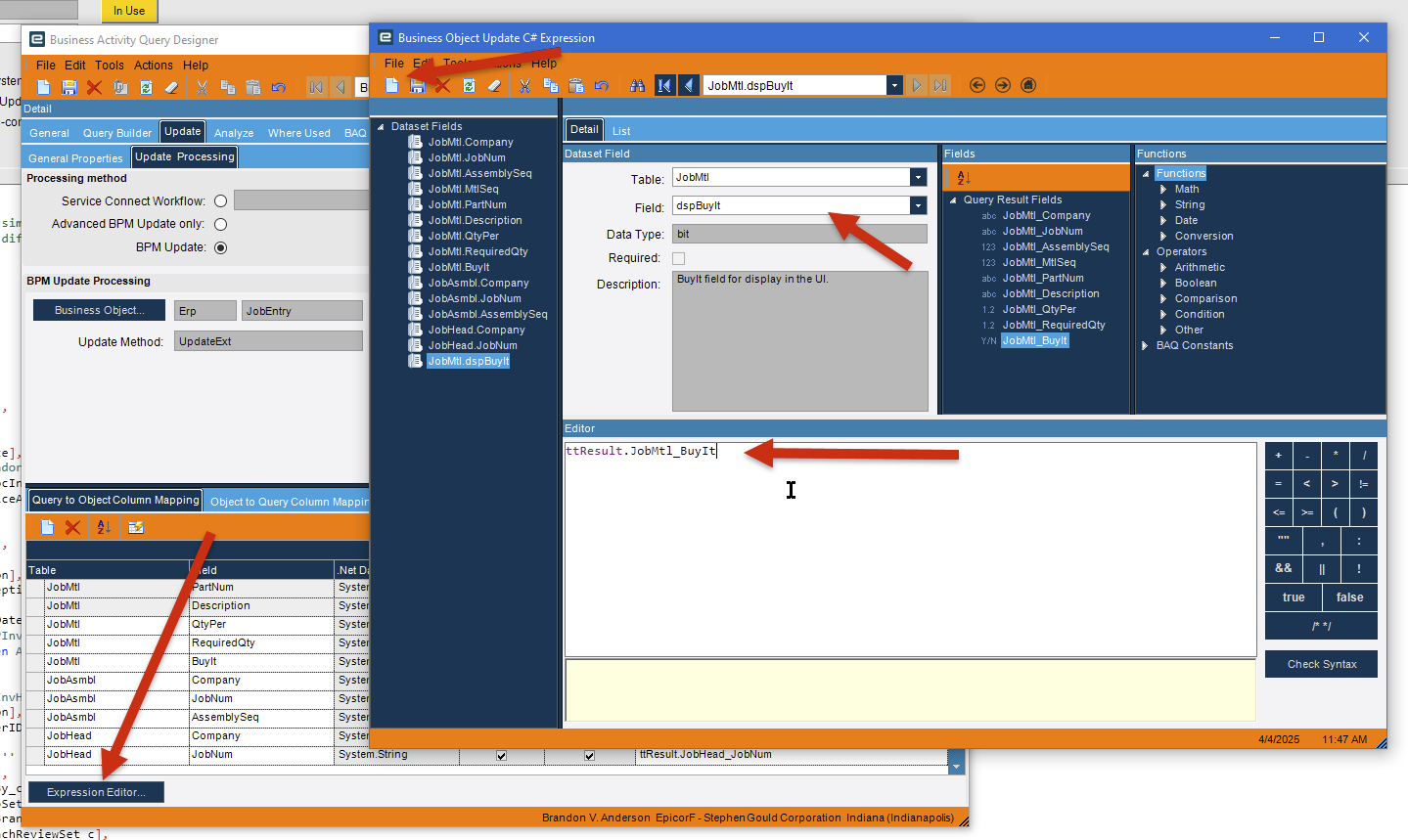

There are 2 columns in the dataset you have to change.

You need to add a field for mapping in the BAQ.
Try this and tell me if it works.
Go here, add a new row, find DSPBuyIt and set to the BuyIt field.
Awesome - yes that worked! Thanks!
