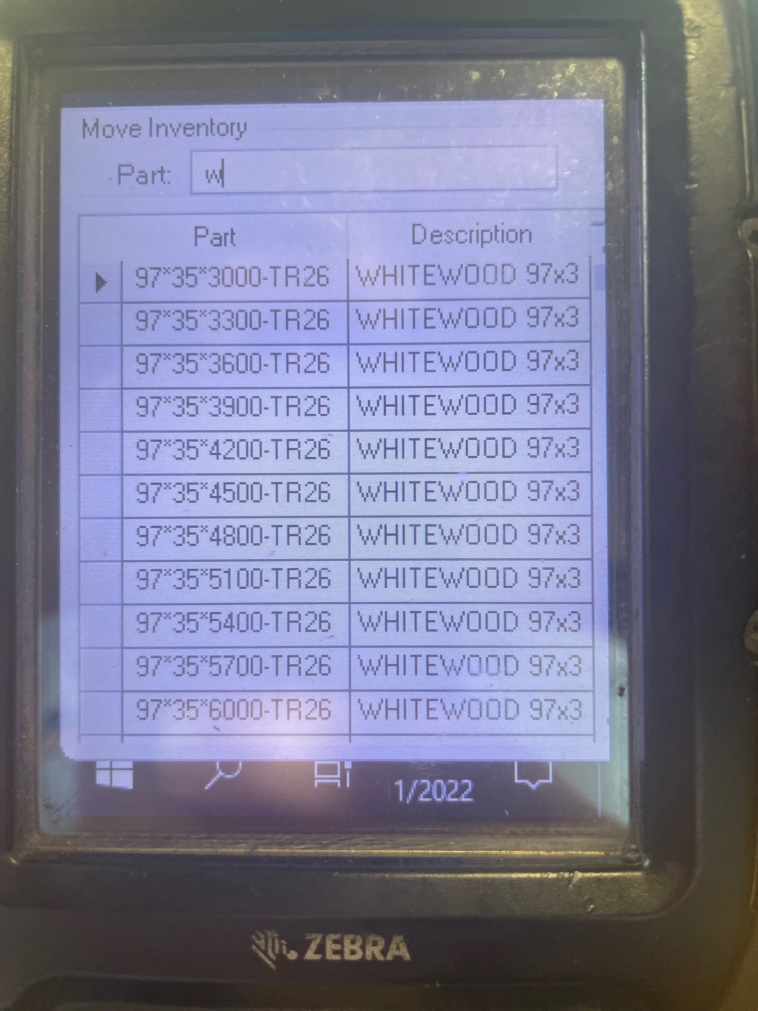

This is what I’m seeing after moving to Server 2019 - no scroll bar visible at bottom and only a small bit at right hand side. More text in the second column than originally.
I’ve tried everything above but no change.

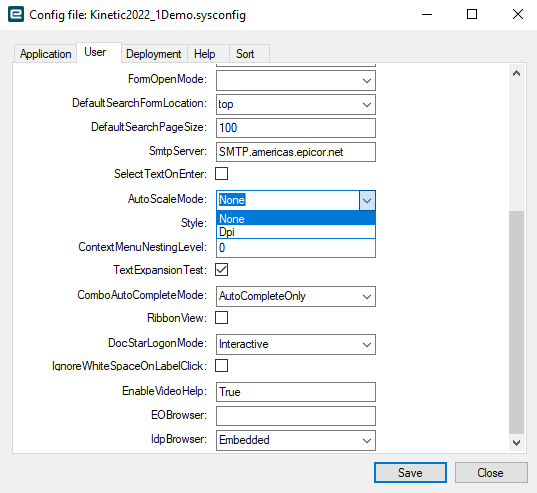

I meant also to mention have you looked at the Autoscale mode in the sysconfig?
From the help.
User Settings
Setting Purpose and Expected Value
AutoScaleMode The concentration of pixels on the window, this setting accommodates different geometries of forms in different versions of Windows.
“None” – The default. No adjustment of forms is done.
“Dpi” – An adjustment (dots per inch) of concentration for pixels is done on forms.
The forms are adjusted to adhere to the DPI field on the Display Properties > Settings > Advanced General form in Windows XP and Control Panel > Display > Custom DPI SettingS form in Windows 7. Common settings are 96 DPI and 120 DPI.|
