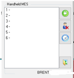

HandHeld menu shows just numbers
This week for some reason our HandHeld menus only show numbers and not the menu item.
Has anyone seen this before? Any suggestions welcome.

This started on Monday so we are 5 days into using numbers to navigate the menu’s.

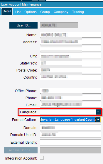

I wonder if you set your language to Blank in User Maintenance as a work around if it will default to Invariant again.
Mr. @hkeric.wci - thank you for the suggestion. I deleted my “Language” field and then restart Epicor (to force it to re-read the profile). The language field stays blank.
I then launched the HandHeld and i get the same numbers instead of menu names.
Thanks again for the suggestion.

@hkeric.wci - My language was blank in my UserID settings.

@DaveOlender - Thanks. Sure enough, fixed on .9 and we’re on .8. I changed my user account language to blank and re-started the Kinetic client, no change. Maybe something is set on the company level and should be left blank there? I couldn’t find anything in Company Config, however. I tried copying the DLL from 10.2.700.6 into the 2021.2.8 client folder, but it errored out when launching the handheld menu.
