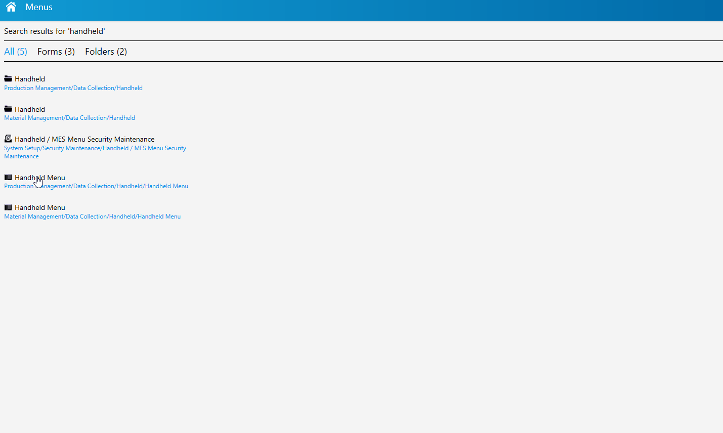

I’ve tried 2 ways to add an item to the HH menu - both work, in that the menu item appears and works for the first time of asking.
Method 1
Using customisation and reflection to add the items
Method 2
Inserting into the Erp.MESMenu table
Both instances call a menu ID called “HHCSPUT”, which is setup in Process Calling Maintenance to run with a customisation layer. The first time you load the HH menu and click on it you get the correct customised screen - but if you come out of that screen and go to another, then come back - it only displays the base form without customisation.
You then have to fully exit HH and start it again to be able to use the screen 1 time.
Any ideas why Process Calling isn’t always kicking in?

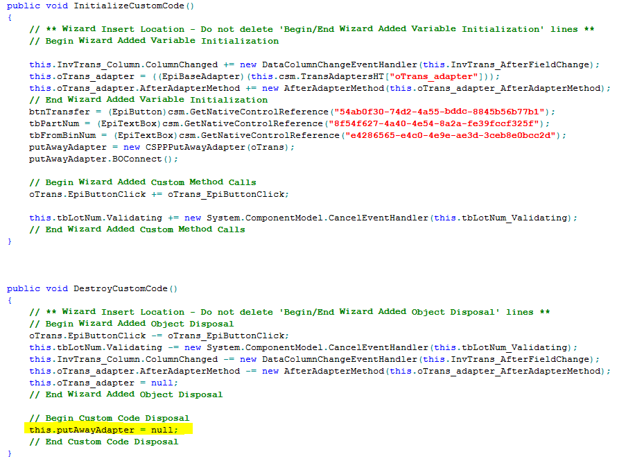

Finally solved this…! The custom code that you see here was created by CSG - and I realised that an adapter was being created but never destroyed. Once I added in the highlighted line of code to destroy it, it started behaving properly and always showing the customised layer not the base!
