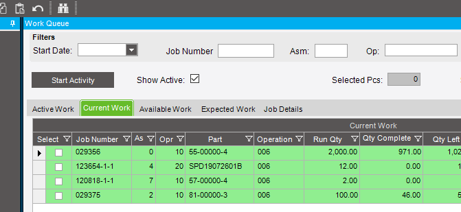

I’m adding some customizations to our WorkQueue. I would like to highlight rows based on available inventory and/or issued material count (or issued complete).
I have setup FKVs\STVs looking at JobMtl and PartWhse, created a Row Rule for testing. It seems to work when I first load the Queue, but when I click on a row things get a little weird. I lose the highlight across the entire row, with only one column being highlighted, and the color that the selected row should be overrides the color of the other rows. Here’s the code, don’t mind the extra filters, followed by a few examples:

private void CreateRowRuleCW_MtlIssuedCompleteEquals_true()
// Description: CW_IssuedComplete
ControlSettings myCustomSetting = new ControlSettings();
//Set it orange
myCustomSetting.BackColor=System.Drawing.Color.LightGreen;
// **** begin autogenerated code ****
RuleAction highlightCurrentWork_RowAction = RuleAction.AddRowSettings(this.oTrans, "CurrentWork", false, myCustomSetting);
RuleAction[] ruleActions = new RuleAction[] {
highlightCurrentWork_RowAction};
// Create RowRule and add to the EpiDataView.
RowRule rrCreateRowRuleCW_MtlIssuedCompleteEquals_true = new RowRule("CW_Mtl.IssuedComplete", RuleCondition.Equals, true, ruleActions);
((EpiDataView)(this.oTrans.EpiDataViews["CurrentWork"])).AddRowRule(rrCreateRowRuleCW_MtlIssuedCompleteEquals_true);
// **** end autogenerated code ****
On Load:
After clicking a new row:
Any idea how to fix this and make it highlight each row independently based on my criteria?
