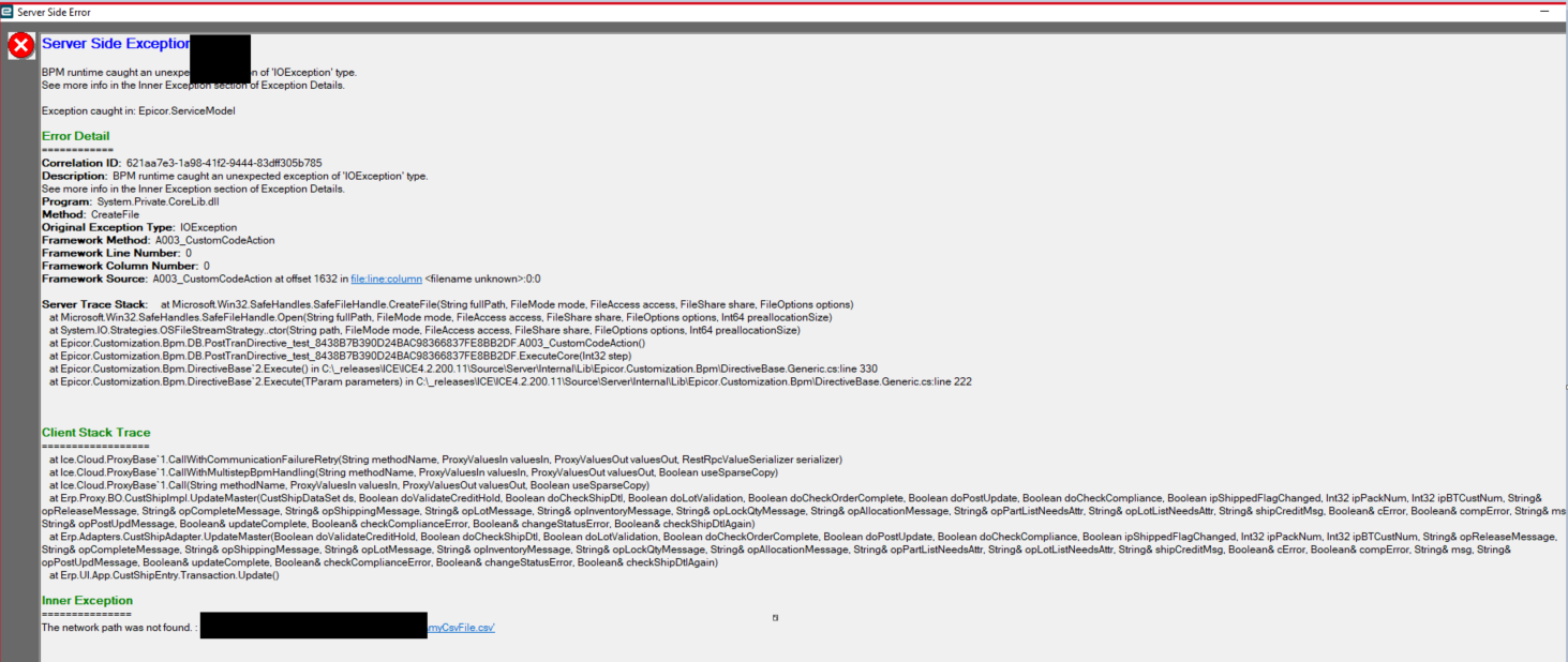

We need a way to export a CSV when a user marks a Customer Shipment Entry Header as “Ready to Invoice”. This file then needs to be deposited on our network at a specified location.
Currently, I have a Standard Data Directive under ShipHead that creates a StringBuilder and exports the data as an email. However, when I go to create a file and ship it to our location it bugs out and gives the following error:
Current Code:

To use our BarTender, Epicor created a folder somewhere on their server (I’m assuming) that we can dump the files to. I would ask support to create a folder for your company to drop out these files and then you can monitor the folder and move the files to your network.
Same. Epicor support created an FTP folder for us to send/receive files to.
Originally we just used it for Bartender but found that the BAQ export can run a query and export the results to the same folder which is handy for automation.
Now if I run server side BPM code can I access any files that I write?
