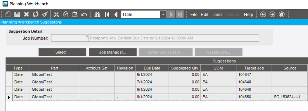

I unchecked the “schedule before today” checkbox and reran MRP, Global Sequence order, and Global Scheduling. I am left in the same boat. The planning workbench suggests I move the stock jobs to the correct dates, but global scheduling will not reschedule the jobs to those dates automatically. The test part I am using does not have any min/safety/max so I am unsure as to why they will not move.
Is there a different process to execute all planning suggestions from MRP?
