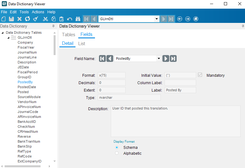

I see PostedBy in GLJrnDtl. It may not be exposed, but I can see dates and usernames in a BAQ:

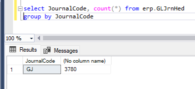

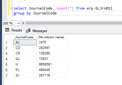

I think it’s the other way around: We currently only have GLJrnHed records for our general/manual journal entries and no records for subledger entries. In fact, does Epicor even create GLJrnHed records for subledger journals created by the Posting Engine?
GLJrnHed
GLJrnDtl
The automatic entries are definitely getting deleted. The manual ones are not.

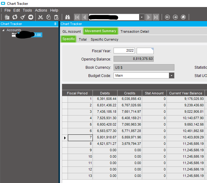

Chart Tracker will give you the details behind each transaction:
Select the Period:

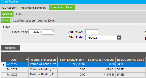

Select the transaction you want to drill into:

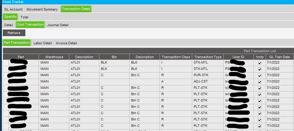

Use the Cost Transaction tab to see the actual subledger transactions causing the financial transaction:
Chart tracker is great! It did not have the created by but is a fabulous took for troubleshooting.
