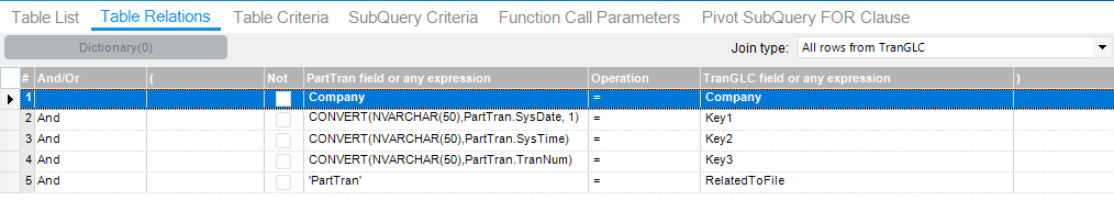

Since I just spent a few hours figuring this out, I’ll share what I found and how I was able to link multiple tables to TranGLC. This information is covered in KB0028094: Adding GL Account to a BAQ
Overall, the BAQ Designer is just a GUI interface for building a SQL statement. To create the relationships between TranGLC and multiple tables, you need a more advanced SQL statement. Not many BAQ users realize that you can add expressions into Table Relations instead of just choosing fields from the dropdowns.
Per the KB article, when you link the tables to TranGLC, you need to specify the ‘RelatedToFile’. For example, if you link PartTran to TranGLC, you should specify TranGLC.RelatedToFile = ‘PartTran’. Also, since the TranGLC key fields are all data type NAVCHAR(50), you will need to convert some key fields of the linked tables to NAVCHAR(50). I will use the PartTran table as the example again. When you create the table relations, type in the expression CONVERT(NVARCHAR(50),PartTran.SysDate) instead of just choosing SysDate from the dropdown. Per the article, you need the full TableName.FieldName format. Please see the screenshot below for how to link TranGLC to PartTran.
For other tables, you will need to make similar conversions. Per the article (question 4), boolean and date fields require special attention. For boolean (true/false) fields, you will need to do a CASE statement instead of converting. For date fields, you will need to add a ‘1’ to the CONVERT function to specify the style. Please see the article for examples, but I also copy/pasted the Q&A for questions 3 and 4 below.

In the BAQ designer, you will need to click into the expression within the criteria and type in the CONVERT formula manually. This also requires using the full TableName.FieldName, you cannot use only the FieldName.
