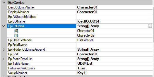

It sounds like you may have complicated this a bit.
If the data is in a UD table, then use an EpiCombo (not EpiUltraCombo). It will do the linking to the table for you if you select the right adapter (no code). Also, you can filter the data based off of another field on the current table. Lastly, it has the ability to store a description value to another field. All without a line of code in the script editor (although a little filtering code on the EpiCombo properties).
Thanks for this, I didn’t know I could to this, so may be another option, but I need to filter the content based on customer ID (one of the columns in my UD table) from the current sales order how would I do this?
Here is a generic filter setup for an EpiCombo.
