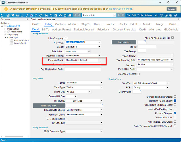

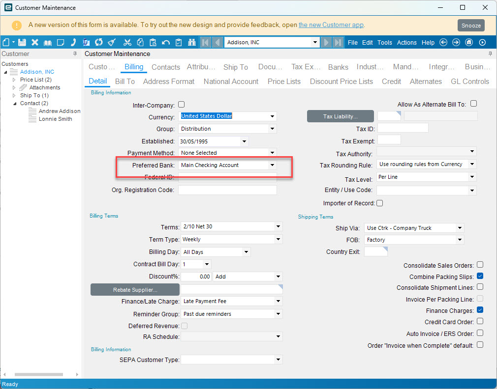

By the way the OurBank gets its information from the Prerffered Bank Account on the Customer/Detail/Billing Tab. So that resolves the issue of trying to work out the account to use on the fly. It just does it based on that field.

You need to update the customer record and set the preferred bank… See above :slight_smile:

Actually I think I know what the issue is the preferred bank needs to be on the customer record before the order is created… Create a baq on orderhed to show the ourbank column.
