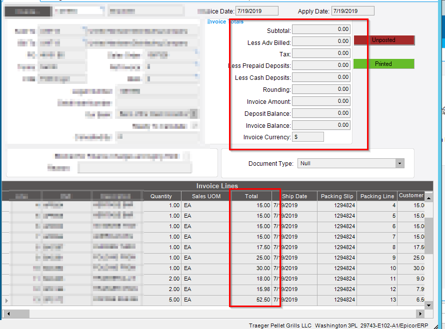

We use the oob process “Get shipments” or called “Create invoices from shipments process” to automatically generate invoices on a recurring schedule. We are now noticing this process is generating zero dollar invoices from sales order shipments. Has anyone else ran into this? This is causing a huge headache for our A/R department. I have engaged support and they are still investigating as well.

Did some digging and it looks like when the task agent encounters an error during the process, invoices are created with zero dollar amounts.
Are there BPMs on the InvcHead or InvcDtl tables?
Hi Jason,
We have a change log enabled on invcdtl and an auto print 810 edi data directive on invoice head. Its defenitly related to the task agent failing however, as all the bad invoice times correlate with when there was a task agent error.
