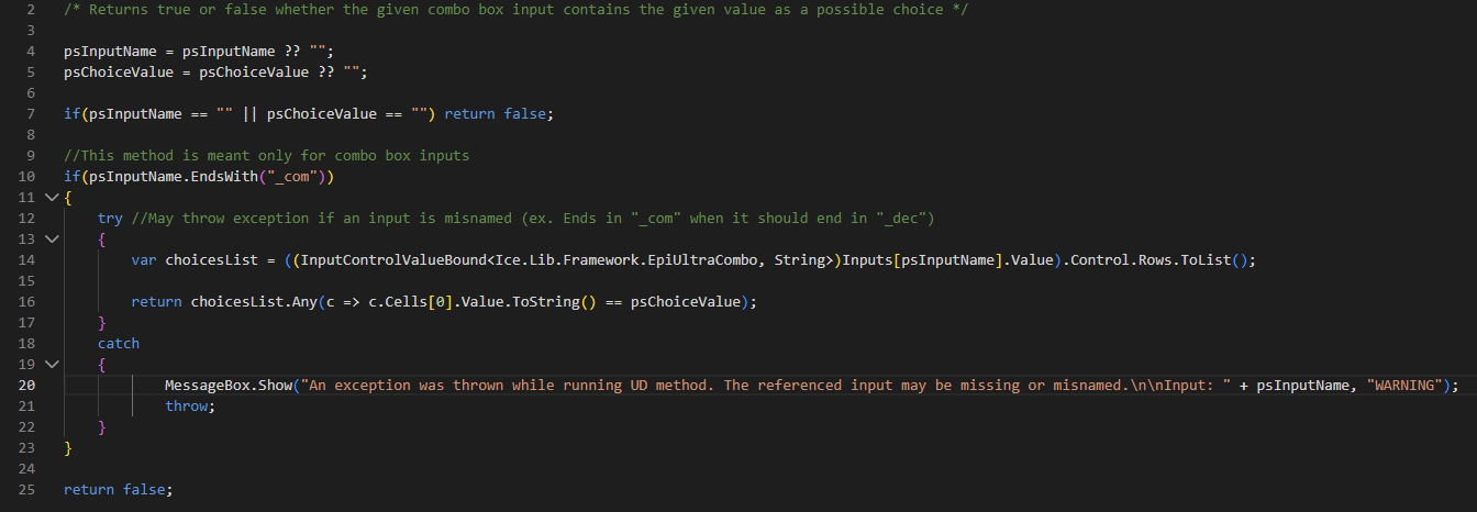

I am converting a Classic Configuration to Kinetic version. The below code which retrieves all Inputs used in the Configurator is throwing error in the Kinetic Version. The control framework on being defined using Ice.Lib.Framework does not recognise the controls used in the configurator. I am also unable to find an Input List in the Kinetic.
Code:

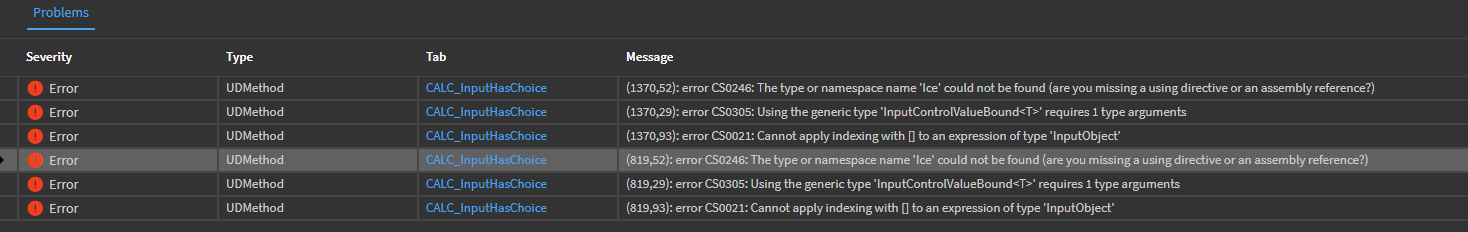

Errors:

It looks like he is checking all combo boxes whose name ends with “_com” to see if they allow a certain choice.
In this particular case, I think the solution would be to move where the logic is for deciding what options are available in the drop down to a UD method, and then check the outputs of those UD methods directly. You shouldn’t be trusting what the client says the options for the combo’s are anyway. People could open the browser tools and add options. (etc etc)

So the Config UD Methods are in the classic version so it wouldn’t give a syntax error there but in the Kinetic Version, it recompiles all the UD Methods again in the designer- irrespective of if you have called them or not. I am receiving the errors on trying to save the configurator designer.

I’ve had similar issues when I bring over UD methods from PROD to our test/pristine database as well. I imagine it’s kind of similar to your issue. A lot of times, I’ve had to rebuild the UD methods from scratch or at least partially.
I’ve never converted any from Classic though, but I would imagine the logic/formatting has changed within the Kinetic configs which is causing the errors. You’ll find as you go along with the embedded configurator, that it’s very particular about what it lets you save/publish. If the logic/asset doesn’t exist in Kinetic, more often than not it’ll prevent you from saving entirely.
