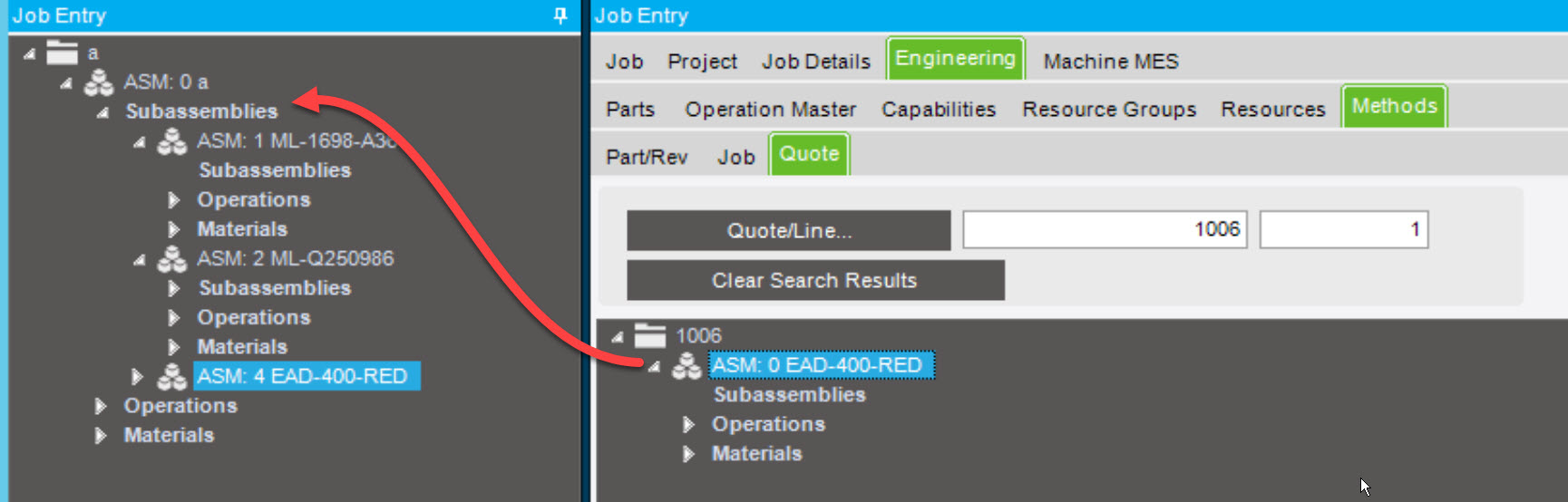

A suggestion would be instead of appending - use the engineering tab in the job and drag and drop the subassembly on to the method from the quote.

Thank you. I did not know of that functionality. Not quite ideal and perhaps it was corrected in later versions, but your solution will work.

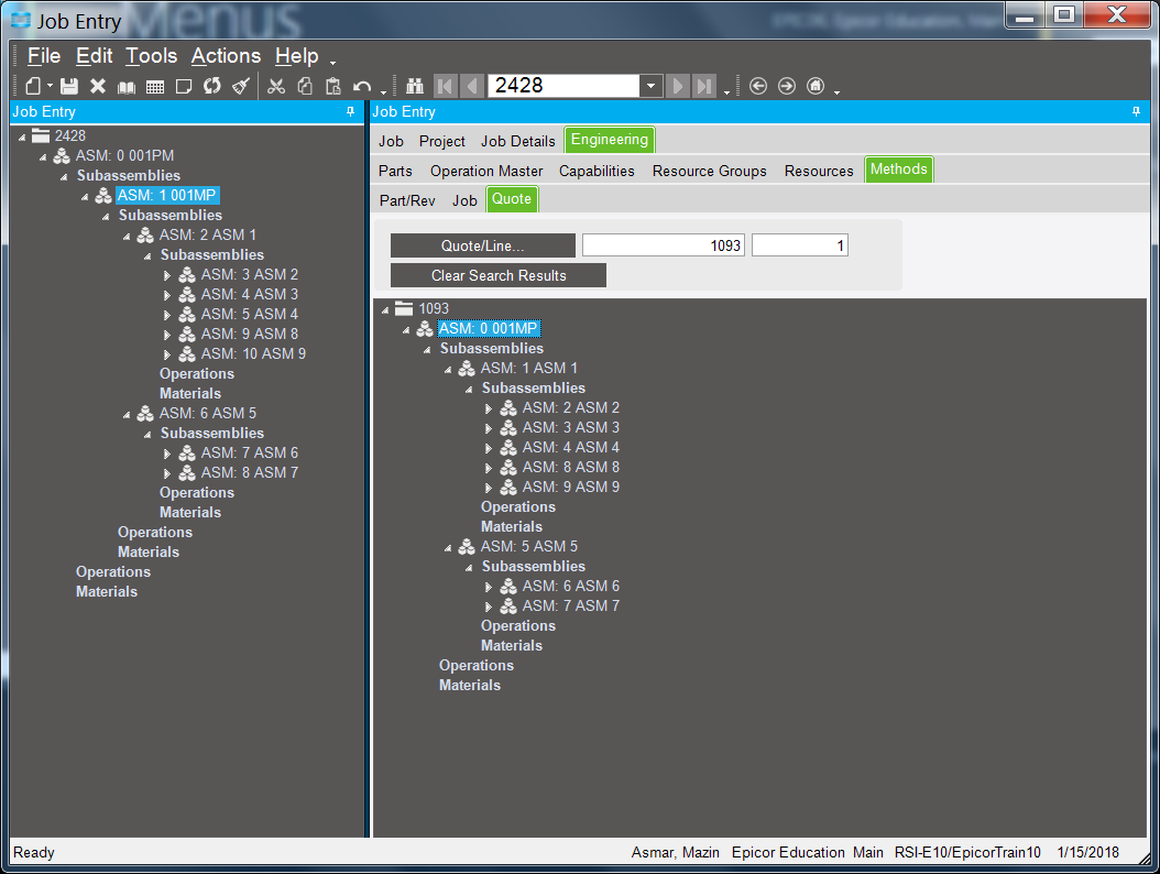

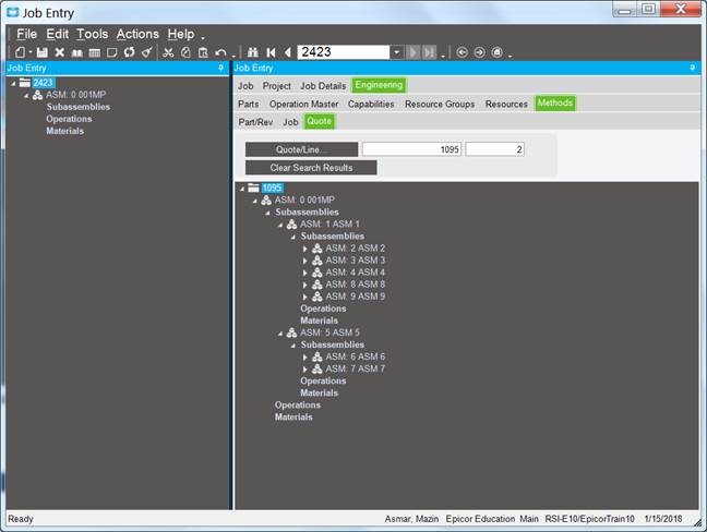

Hi Bruce, I just tested your drag-and-drop suggested method in EpicorTrain10 E10.1.400.16 and unfortunately it did not pull all the sub-assembly details. In fact, it resulted in the same outcome as get-details from a quote second line with many sub-assemblies entered in specific order:
a. Right click on ASM 0 and select Add Subassembly. Add ASM 1 (part on the fly) under assembly 0,
b. Right click on ASM 1 and select Add Subassembly. Add ASM 2 (part on the fly) under assembly 1
c. Right click on ASM 1 and select Add Subassembly. Add ASM 3 (part on the fly) under assembly 1
d. Right click on ASM 1 and select Add Subassembly. Add ASM 4 (part on the fly) under assembly 1
e. Right click on ASM 0 and select Add Subassembly. Add ASM 5 (part on the fly) under assembly 0
f. Right click on ASM 5 and select Add Subassembly. Add ASM 6 (part on the fly) under assembly 5
g. Right click on ASM 5 and select Add Subassembly. Add ASM 7 (part on the fly) under assembly 5
h. Right click on ASM 1 and select Add Subassembly. Add AMS 8 and ASM 9 (parts on the fly) under assembly 1
ASM1
ASM2
I even tested the drag-&-drop method from a Quote with one line only. Unlike the get details method it did not work in maintaining the ASM naming and order; very odd
