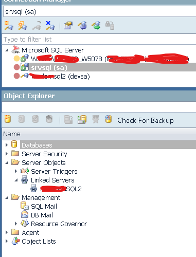

What about the aspect of making a linked server in Server A to Server B. Then you can query external server A and reference linked server B such as linkedserverB.Dbasename.tablename in from clause of ext BAQ?
