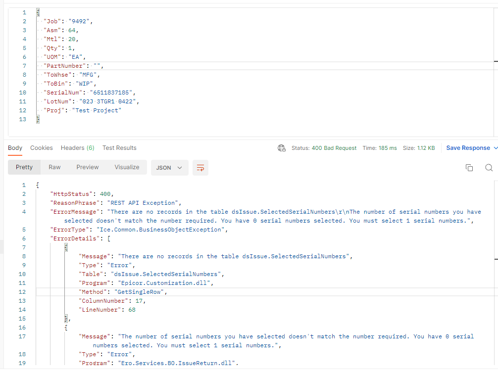

Error(s) are:
There are no records in the table dsIssue.SelectedSerialNumbers
The number of serial numbers you have selected doesn't match the number required. You have 0 serial numbers selected. You must select 1 serial numbers.

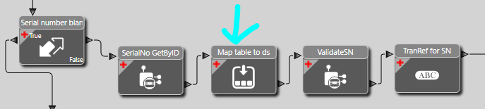

I’m looking at the ‘Map table to ds’ widget and I noticed you didn’t set the TransType there. I’m wondering if that could be the issue as I don’t think it’s set by default when you do the GetNew. Try to set that and see if it works - you could do a trace and see what the correct values are for both issue and return.

LE: the MyQuery you’re using to update the SN’s, you have the filter there SNStatus=‘INVENTORY’ - are you sure that’s correct for returning the materials ?

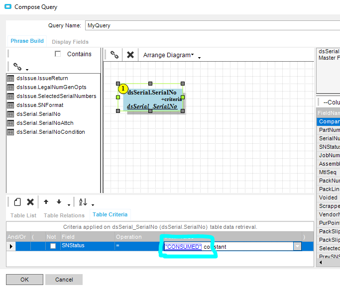

I figured it out. Really, really dumb of me. I had the old criteria on the query.
  • Was SNStatus = “INVENTORY”
  • Now it’s SNStatus = “CONSUMED”
Really, I’m not even sure why I filtered it at all. I did get by ID.
