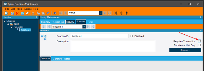

Don’t do that,
The issue here is that you are creating double transactions in your first function.
You are using Ice.Context.CreateDefaultTransactionScope
Which creates a transaction then you are checking create transaction on the function which wraps the whole thing in a transaction
You need to pick one either the default Tran scope or the transaction checkbox

You can’t have Ice.CreateDefaultContext and a Transaction checkbox

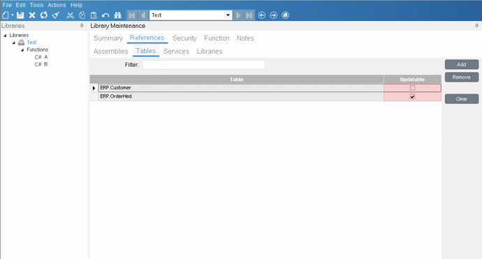

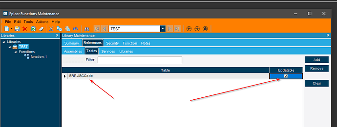

In the Function Setup you need to Add your Tables
You need to select the updatable checkbox for the tables you want to update

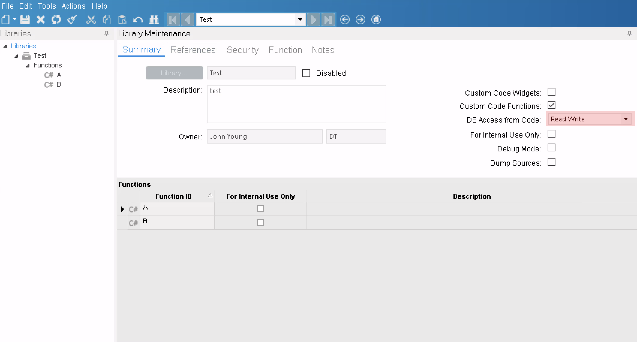

Here’s the Setup
Create Function
Add the Table you want to update (as well as any other table you want to reference)
Mark the table as Updatable
Then in the function just do the update / lookup etc. Db is automatically generated for you based on the selected tables.
var abc=(from a in Db.ABCCode where a.ABCCode1=="A" select a).FirstOrDefault();

If you want the Protection of a Transaction Check the needs Transaction Box on the Function Settings
You should never instantiate your ERP Context Here, or establish your own Transaction Scope that creates double transactions and can cause all sorts of fun record locks and nightmares.

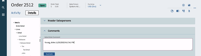

I tested your advice out by making two simple functions. Function A (“Requires Transaction”) sets an order’s OrderComment field with the customers name and time stamp. It gets the customers name from Function B.
It worked and updated the order! Thank you again!
