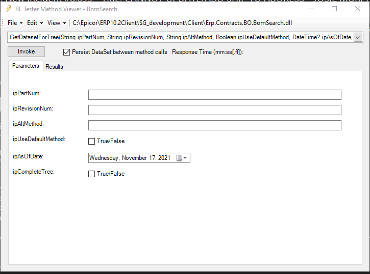

Do you have an effective date set? It looks like it takes an as of date? Try it in the BL tester (or swagger using rest) and see what it returns.
Sorted it out - the GetANewUd20 has a “blank” row when it is called. Updating UD20 when the Database already has a “blank” record was causing me grief. I remove the blank row from the UD20 tableset and I am able to write to the db now.
