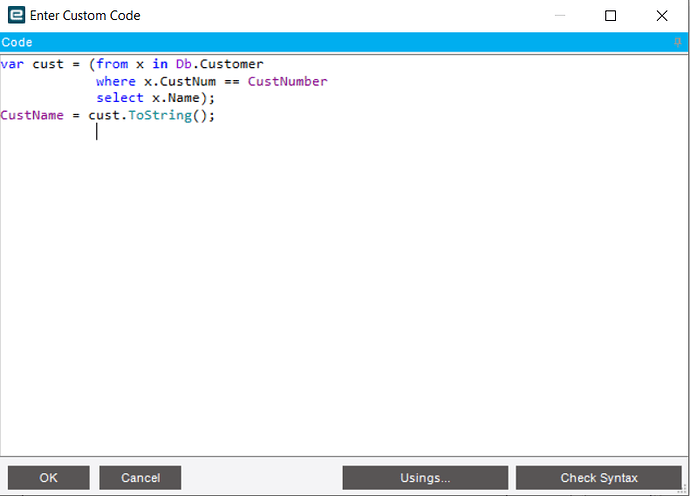

I’m trying to make a function that will take a input value of the customer number and return the customer name here is my code.
and I keep getting these errors .

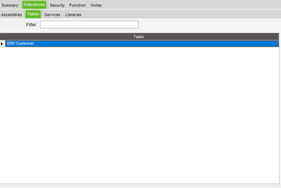

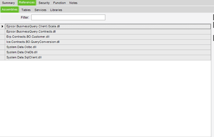

send screenshots of your tabs in Function Maintenance.
These are the only tabs that I have filled in everything else is empty

You could always try something like this:
CustName = Db.Customer.Where(x=>x.CustNum==CustNumber).Select(x=>x.Name).FirstOrDefault();
