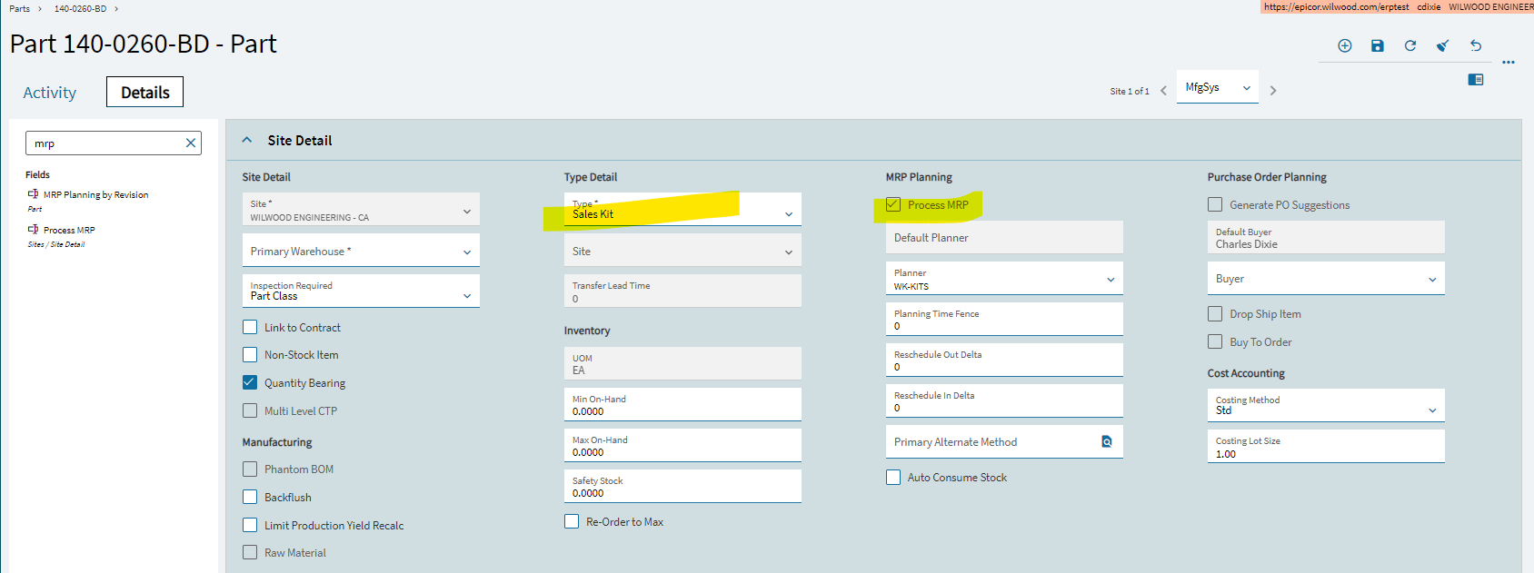

After multiple tests, I found that if I put a forcast on a sales kit, the demand for the materials does not work. I have no purchase suggestions or job suggestions for the materials.
Anyone has an idea how to create demand on a sales kit forecast?
This seems so simple yet the mighty EPICOR makes this difficult.

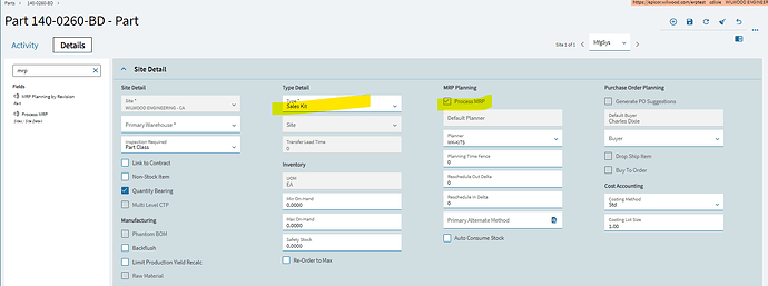

The Process MRP box on your site will uncheck when you change to a sales kit. you need to DMT in that value at TRUE and it will force it to be checked then work!

We have Kits that have a locked in BOM and then a -CFG Kit SKU that we can configure.
We only forecast the Kits with a locked in BOM.

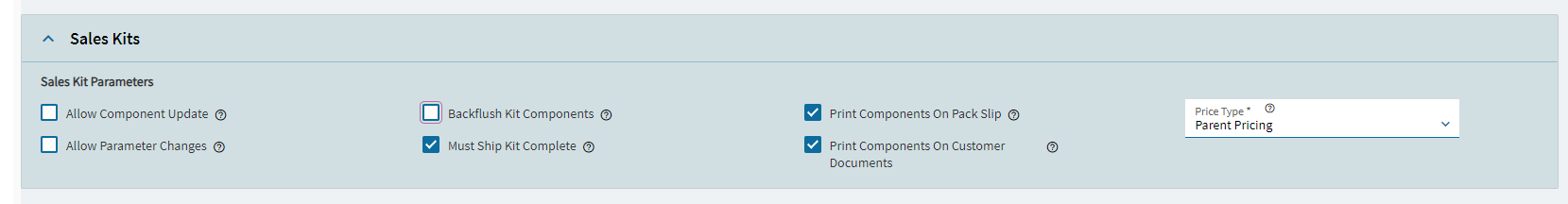

So ibelive in EPICOR we don’t tick the ‘Allow Component Update’ flag on the sales kit drop dowm (see screen shot) for the locked in BOMs that don’t change and we do for the ones that are configuarable / changable.
We are having troupble with Jobs Auto firming when we turn on the Process MRP. So that is where we are with solutions currently.

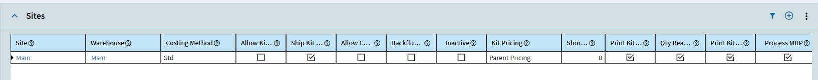

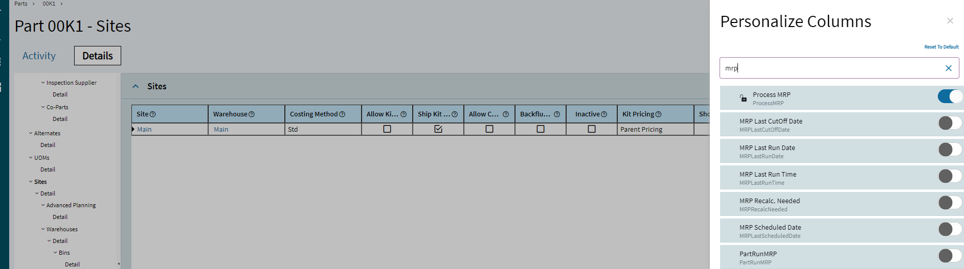

We did find you don’t need to always use the DMT to turn on the ‘Process MRP’ its hidden in the personalise section also of the site detail. (see pictures below)

We have foracast kits by forcing the MRP flag on the Kit Part file using the DMT.
It works…
We then just add the kit part numbers in the regualr EPICOR FORCAST, MRP explodes out the parts and plans acordingly
It does try to make shop orders for the 140- Kits but we just filter those out and let the forcast drop off after 30 days and then MRP drops off the planned Kit JObs, but this creates the demand in the system at the top level
