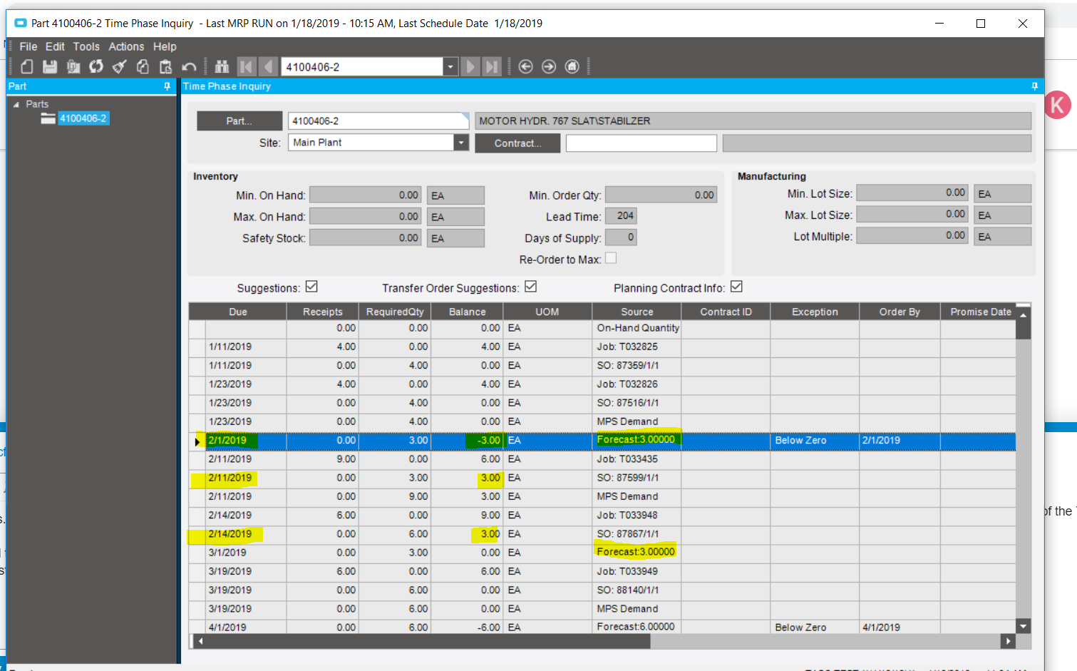

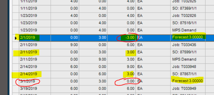

I changed the days before to 30 and have days after at 30. Here is a screen shot of the Time Phase and Forecast still the same…not consumed by a SO. Maybe I am just missing something.

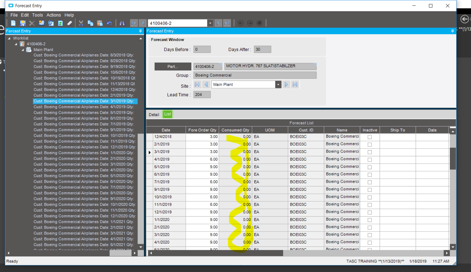

you can see here that in Forecast Entry nothing is getting consumed. There are SO’s for that customer within the 30 days
Hi, having quick glance the timephase is correct.
the consumed qty without looking at the data would need a closer look are you shipping straight from jobs?

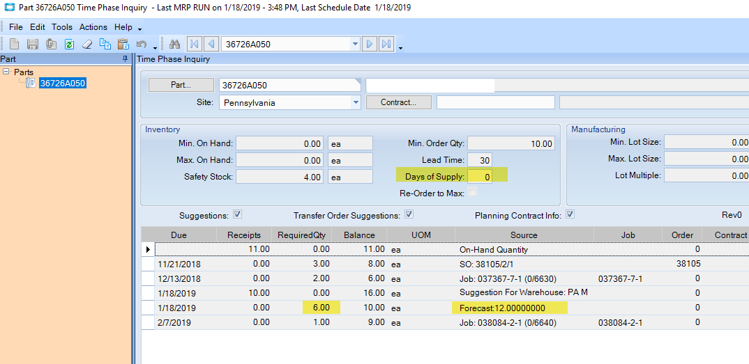

Yeah, I guess you are right, per test below. We use days of supply always to combine demands but I guess for forecasting it is not required. We use forecasting but do not want it to get consumed. We use it to drive long lead purchasing suggestions.
However, I ran a test on a part and pushed out the forecast 150 days before and after and 0 days of supply. The forecast of 12 is consumed by the orders and the job. I have it in generally, not against any customer. Have you tried running it generically first, no customer, to see if the customer tie might be the problem?

So this is fairly new to me. I don’t see how the forecast is consumed in the Time Phase in your screen shot. I guess I just don’t know how to read this right.
The forecast is for 12 (look at source column) but the required qty column shows need for 6. I think this is because I have sales order demand for 3 + Job demand for 2 + 1 = 6 demand consuming the forecast.

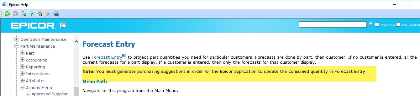

Are you running either generate PO suggestions or MRP? We run MRP. Looking at help i see this in regards to it…
Yes suggestions run when we run MRP and we also run PO Suggestions on Tuesday when we don’t run MRP.

Can I ask some silly questions, it looks like you are mps, forecasts and po suggestions against the same part? Irrespective of any epicor logic is demand correct? In the sense where the demand comes from. Your time phase seems to be correct in epicor terms, so is it just the consumed qty against the forecast in the forecast entry screen we are worried about?
Correct. We don’t see the Forecast getting consumed. That is our issue. Even when I look at the forecast Entry screen the column for consumed qty is 0 for ALL my forecast.
