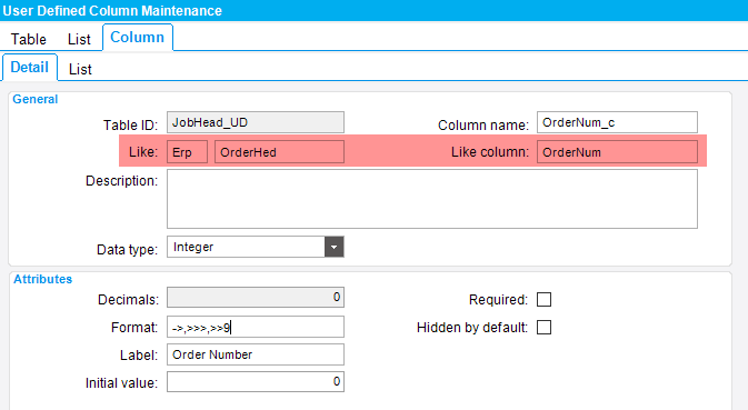

Not sure but you can try to add the original field LIKE data to the custom fields in JobHead and see if that will get you there. My example is OrderHed so you will need to change that to OrderDtl but you get the idea.
If that doesn’t do it, a BAQDataView will do it for you.

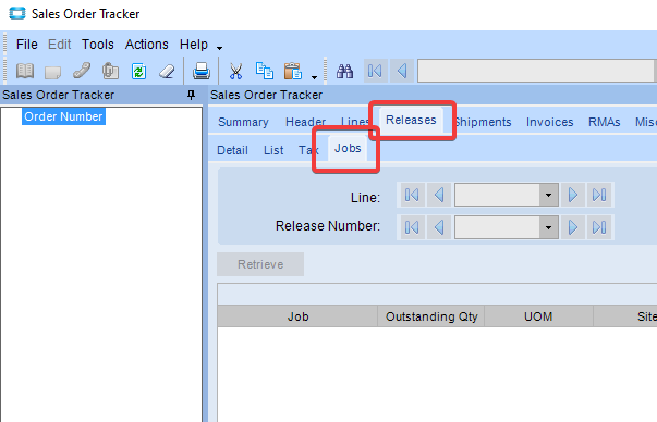

I believe the Job information is already available in the Order Tracker. Jobs are related to the Order / Line / Release…

Note: the default job link in Sales Order Tracker shows manufacturing jobs for the Sales Orders. We have a custom made link to maintenance jobs and that is what I am trying to show.
