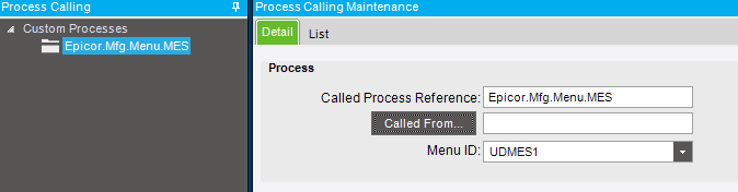

I’d love to know this as well. When I asked a similar question, I was pointed to a menu called Process Calling Maintenance. Supposedly you can specify the Erp.Menu.Mes.dll as a reference and specify the custom menu ID and it’s supposed to automagically work for all clients. Or at least that is how I thought I was told. But I never got mine to work like that and had to go touch all our workstations to update the sysconfig file.
I came across that same set of instructions, and did what it asked…but just like you it was a ‘no go’.

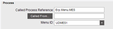

I also tried changing the Called Process Reference from Epicor.Mfg.Menu.MES to Erp.Menu.MES, thinking that maybe the instructions were incorrect, but that was a no-go as well.

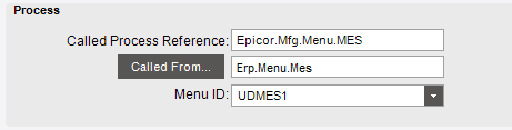

I did both of those options with a “Called From” set too:
Also a no-go.

I turned on Dev mode for MES and clicked the System Monitor button which shows the Calling App as Erp.Menu.Mes:
This solidifies my thought that using Erp.Menu.Mes is the correct reference to use here:
