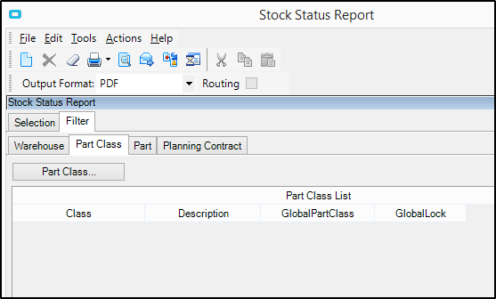

Stock status report can give you stock levels by part class

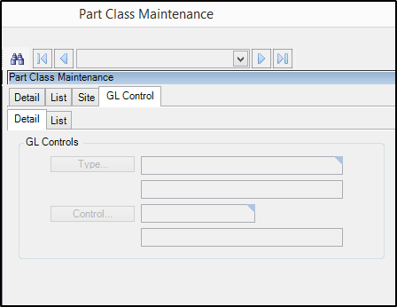

Find the GL account associated with the part class in Part Class maintenance.
Then filter on the part classes here in the stock Status report.
Run the report separately for each group.
