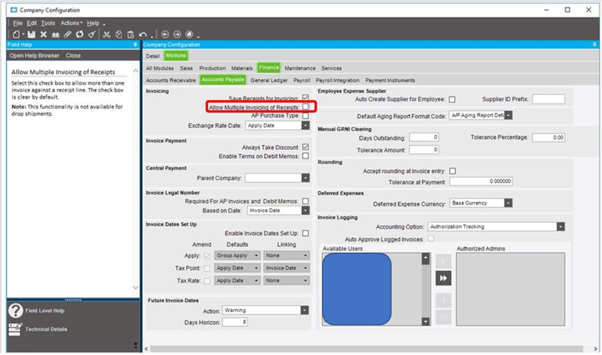

I wanted to report that I talked to an Epicor Consultant and he told me about new funtionality in Epicor 10 that Allows Multiple Invoicing of Receipts. But you have to activate this functionality by checking the Company Configuration - Modules - Finance - Accounts Payable - Allow Multiple Invoicing of Receipts checkbox.

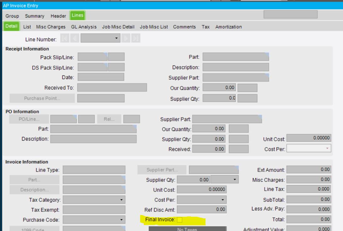

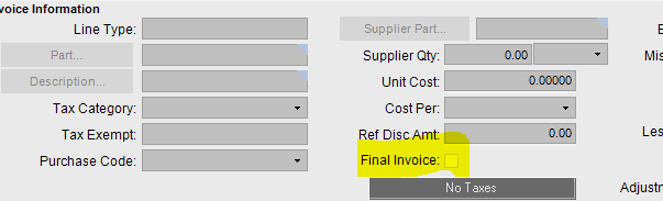

It depends what release of Epicor 10 you are on, Epicor introduced some functionality where you can flag the line as the final invoice, this is ticked by default. If you uncheck it, it allows you to create another invoice for the receipt line.
final%20invoice
We use this a lot and it works well. I will add that in our case, even if you check the box in company setup the final invoice checkbox will still default to true during invoice entry. Meaning, even if you pay a partial receipt and don’t uncheck this checkbox it will still close the receipt short. Maybe this has changed in a future version but you need to keep an eye on this checkbox.

Just have AP create the partial invoice for the receipt and uncheck the FINAL INVOICE checkbox on the invoice detail tab and you should be good to go. The remaining receipt will wait out there for the next invoice.
You don’t have to jump the invoice/receiving hoops you are mentioning.

Thank you guys so much for the information on this Final Invoice checkbox! I will pass this along to our Finance team. Who knew it was that easy!? So what would be the benefit of checking the “Allow Multiple Invoicing of Receipts” checkbox in Company Configuration if the Final Invoice checkbox can allow for that anyways?

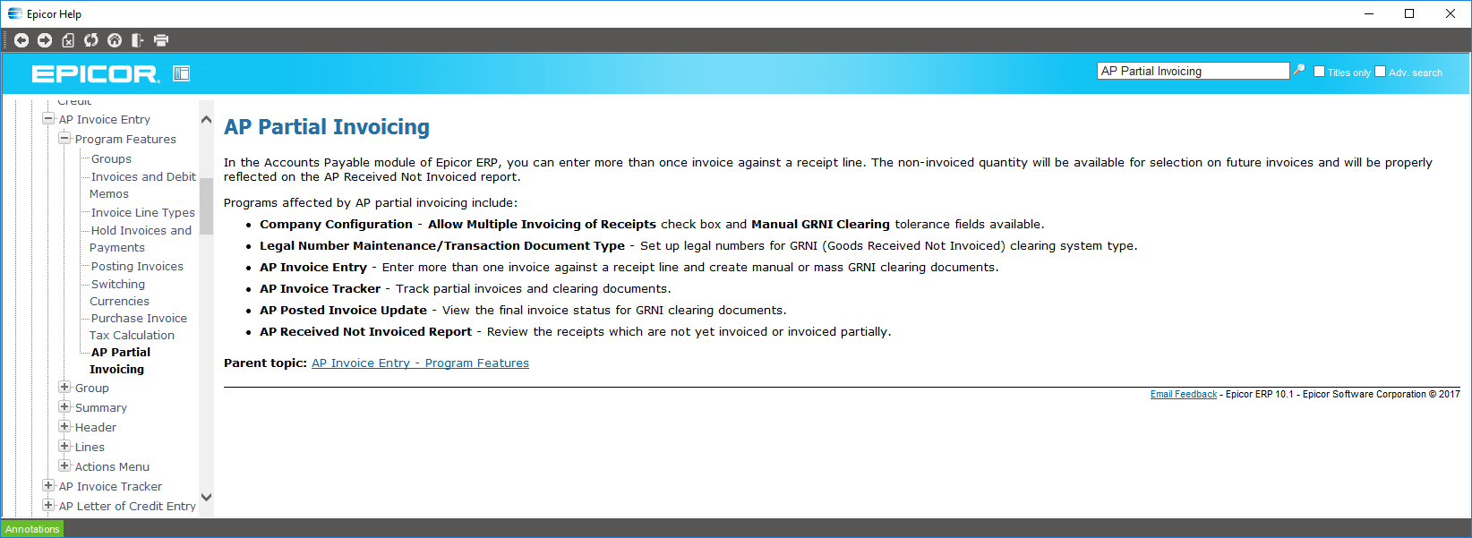

I found this in the Help:
From my understanding of their testing, I think our Finance Department was extremely happy when the Manual GRNI Clearing tolerance fields opened up because I think they were having to do some extra manupulation to fix those in the GL? So I think we will keep the Allow Multiple Invoicing of Receipts checkbox checked AND keep an eye on that Final Invoice checkbox.

For anyone else who finds this very helpful post. The “Allow Multiple Invoicing of Receipts” enables the “Final Invoice” field to be used. Otherwise it is grayed out :grinning:

AP Invoice: “Final Invoice” checkbox on Line should default to False for partial invoices, to avoid lockout from invoicing Private
In AP Invoice, the “Final Invoice” checkbox always defaults to True.
However, when the current invoice only invoices part of the received quantity, the user usually does not think to turn off that checkbox.
Then, when the final invoice does arrive, they cannot do invoicing of the remaining received quantity (requires turning off “Invoiced” in receipt detail line).
If the invoice is not invoicing the whole receipt quantity, the Final Invoice checkbox should default to False.
