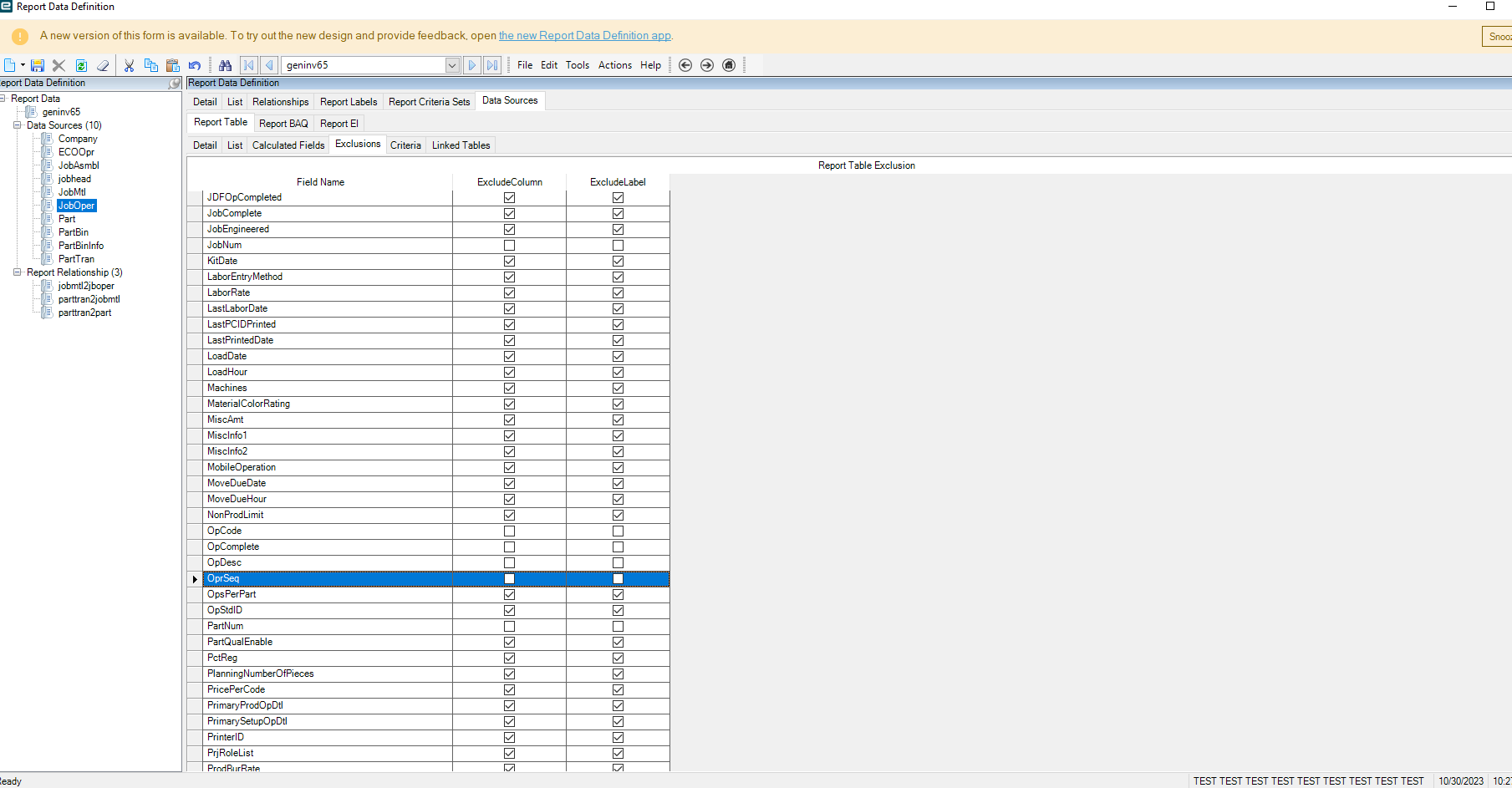

It is not in Epicor. It would be in the SSRS rdl file on the server. You cannot filter out of the box or copied out of the box RDDs. You could create your own BAQ to then create a custom report.

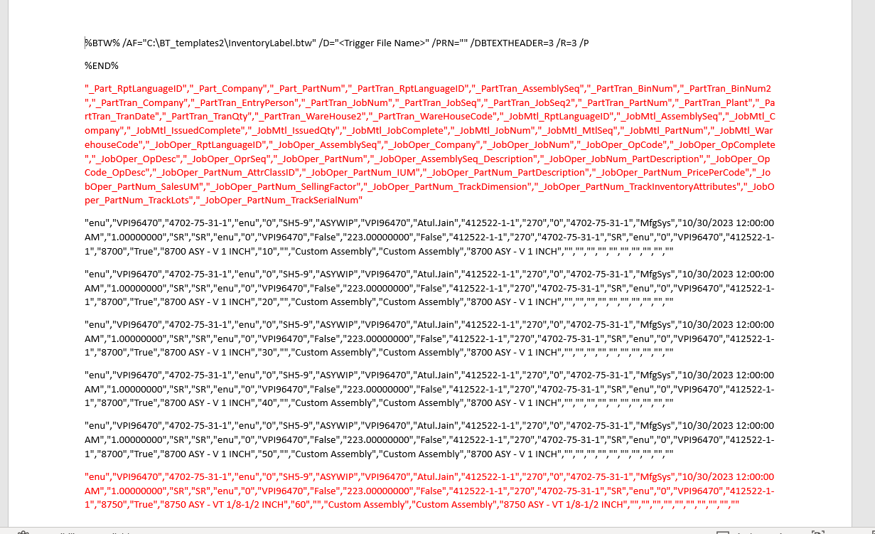

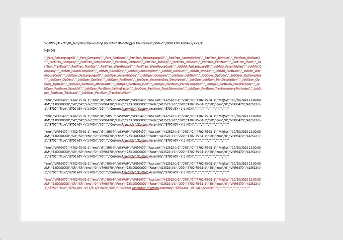

I am trying to create a bartender label, need to create a BT file. The file I am getting is below:
I only need the last result marked in red.

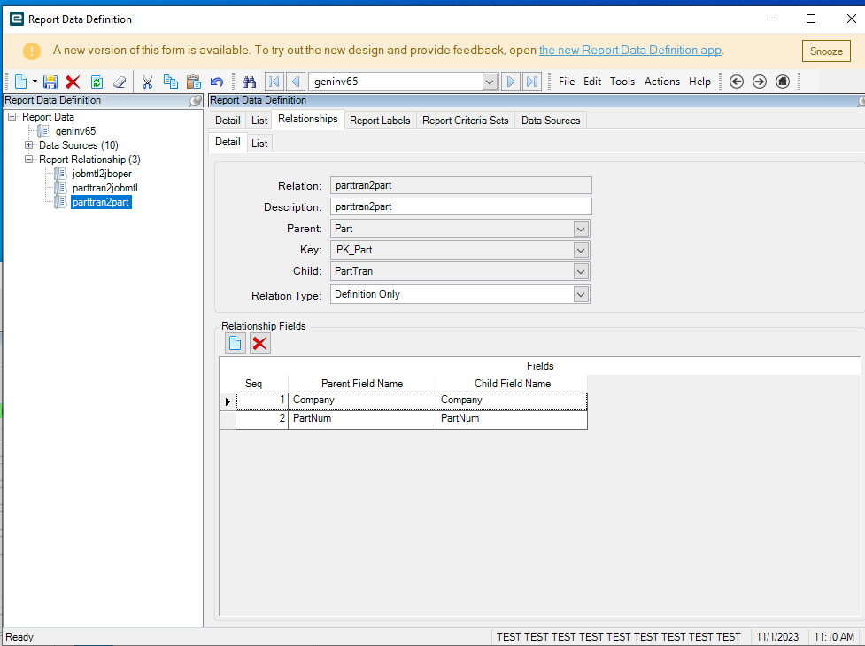

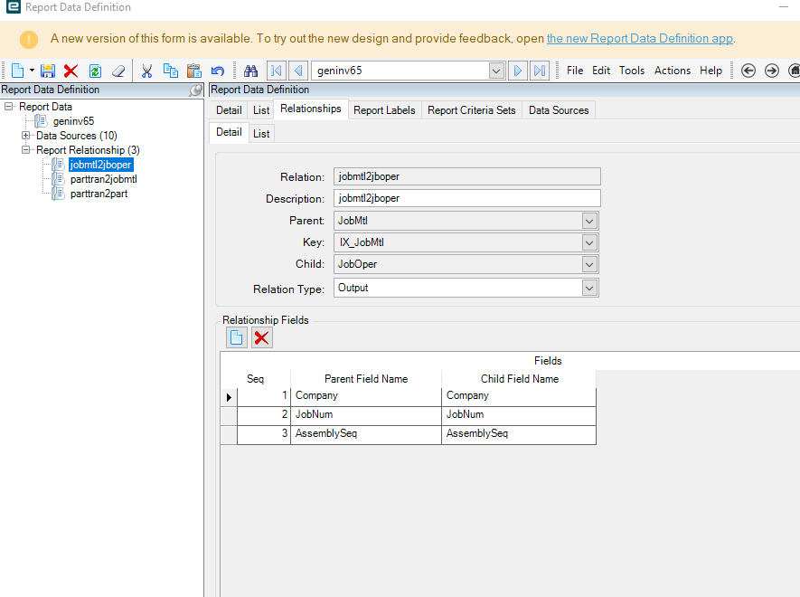

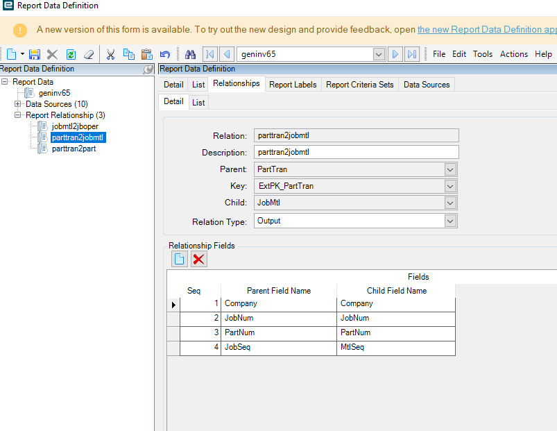

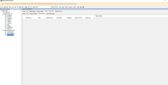

Mr. Atul: I would look at the Joins in your RDD - maybe you are getting multiple records from the joins.
Could you show the joins for the 3 relationships?

Below are the relationships:

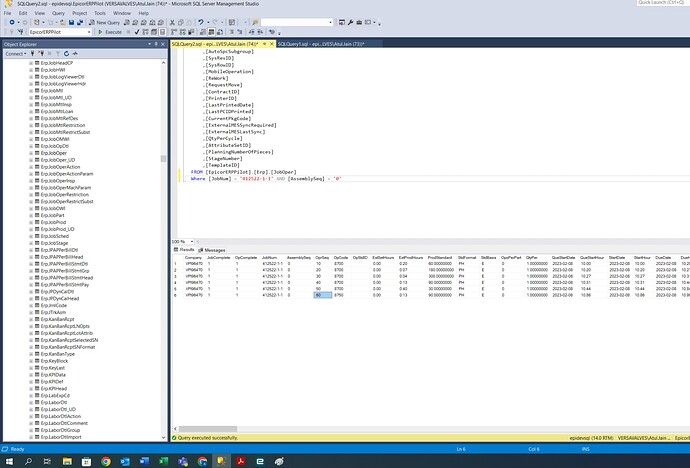

And this is the result I am getting:
And on the SQL server side, I need to select Max value of OprSeq which is 60 in this case, but I am getting the values of all oprseq.
