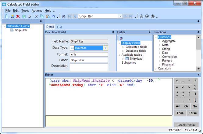

Have you tried a calculated field that is “y” or “n” depending on the month criteria and then do a Subquery criteria to select only the “y” calculated records?
Mark W.
Mark,
Hmm, interesting idea! Are you thinking an except subquery on the Y/N field?
Would you mind pasting the query phrase? Then we can see which data field you are trying to filter and the impact to the other table results.
Mark is saying, to use a calculated field in the Innersubquery, then your toplevel query would select all item in your innersubquery that are Y (Y being the records you want to show).
I was think something like this:

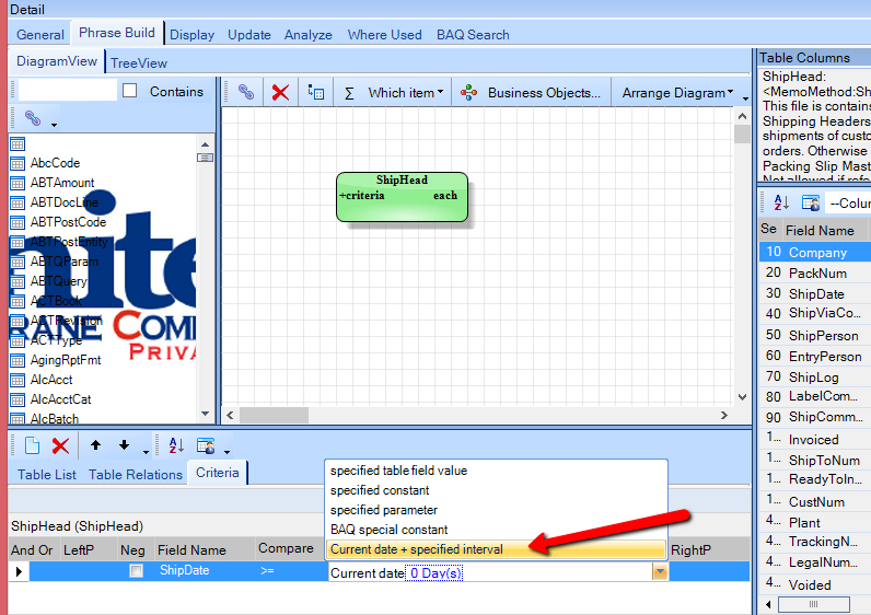

Hi Randy,
I think there is provision for date criteria i.e before or after from Today’s date constant.
You can create criteria for shipHead,shipdate > 30 days, to display those shipments, which are shipped in past 30 days only.
I have added this criteria by selecting following option in phrase builder and it works very well.
After that, enter your days value, if it is before today’s date, enter -ve value.
Ultimately, ur dependent table will show the results.
