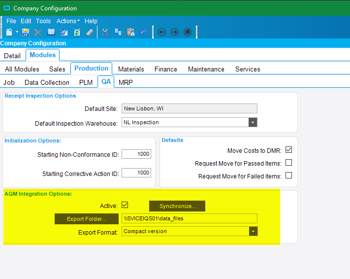

You were so close Haso, and Epicor Support finally gave me the last piece of the puzzle. It was the Advanced Quality Module integration (with IQS Trubox). Somehow my IQS VM was shutdown, and thus the file share it writes CSV files to for certain record updates was not there. Interesting shortcoming of putting that file share on the IQS server itself (which is how Epicor Pro Services did it) - maybe it would be better to have that share on the Epicor app server and have IQS remotely watch for the file drops, since keeping Epicor humming along is much more important to the company.
