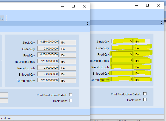

It appears that for this user, decimal places are not showing properly and there are some alignment issues on forms that are specific to them.

Below is an example of what most everyone sees and what the user in question sees highlighted:
This little confusing issue turned out to be a disconnect between two seperate installations of Epicor for this user. The user utilizes both the fat client and an instance on our terminal environment. After getting rid of all profiles and connecting, this cleared up.
Chance… We did clear the files in the paths that you reference here. Just had to make sure everything was clear for both installations.
